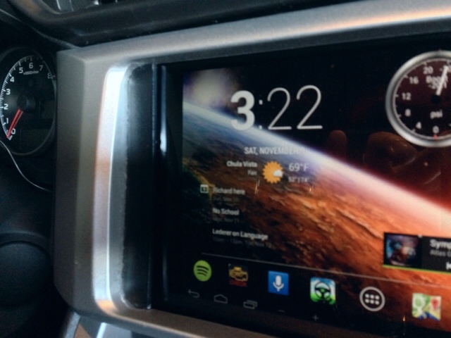

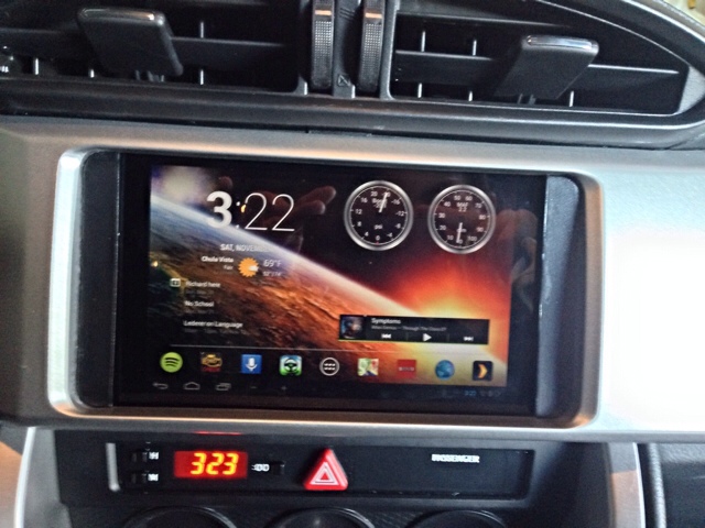

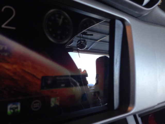

Sojhinn 11-09-2013 06:33 PM
3 Attachment(s)
Originally Posted by ike44 (Post 1321497)
Any way you can get a better pic of how you utilized the dash kit? I have a piece of black cloth covering the sides of my gaps and I am curious what yours looks like in better light.
Here are some more pictures. I modified my install a little further. For those that are more adventurous.
When cutting the metra dash trim pieces cut them so that the visible side of the plastic will be flush with the dash. I epoxied these pieces onto the dash and it came out great. No more gap!
Attachment 56751
Attachment 56752Attachment 56753
Sojhinn 11-10-2013 12:23 PM
Oh and by the way. Don't use super glue. This plastic does not like it. I learned that the hard way.
