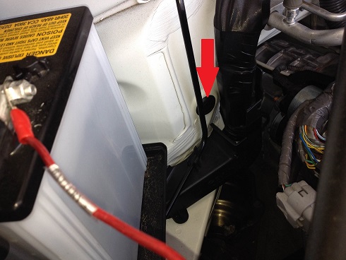

I started with this:
Attachment 55674
The amp and sub installation is pretty straight forward. I looked around to see how other people ran their wires. I ended up going for the straightest line possible. I fed the amp power line through the grommet near the center of the firewall.

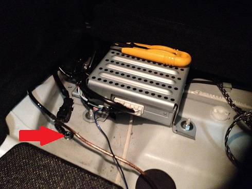

I continued running the amp power line down the passenger side of the center console. I hooked the RCA's in the factory HU and ran them down the driver's side of the center console. I didn't get pics of this part since it is self explanatory.
I tapped into the dark green wire that runs to the factory amp for my signal wire. The arrow shows where I attached the amp ground wire to the chassis.
