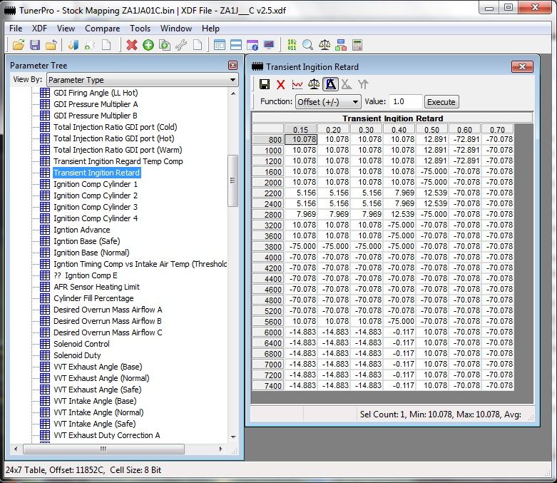

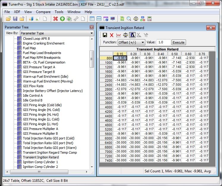

vgi 11-03-2013 07:53 PM
does anyone know why values in TIR table for the v1.31tune look ok
http://i803.photobucket.com/albums/y...ps3c19e126.jpg
but TIR values for stock rom look way off?
http://i803.photobucket.com/albums/y...pse4500ab6.jpg
am I doing something wrong?
Shiv@Openflash 11-03-2013 09:00 PM
There is still a possibility that the XDF file isn't scaled correctly for the transient retard table. This would be easy to confirm if it weren't for the fact that all curent OTS maps are derived for the A00C rom with the nominal values from the A0C rom copied and pasted into it.
So this means that the TIR values in the OTS maps are jerker correct or 20 degrees conservative. Hard to confirm this practically since this map is only active for a fraction of a second at a time during throttle transients. So to eliminate any doubt, the new OTS maps I'll be releasing tomorrow (or Tuesday) will all be native A01C roms and will be accompanied with an updates XDF. I've been testing these maps for the last couple of days and I think they feel a bit more responsive between shifts which would support the notion that the previous OTS maps had the transient retard table was scaled incorrectly. Or it could just be my imagination.
