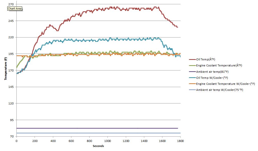

The first thing I did to my car was make a custom Radiator with integrated oil cooler. Here is the before and after temp data for a 20 minute run at Nelsons Ledges in Ohio
Attachment 54994
the OE oil temp sensor is after the filter and thus after the oil-cooler. I haven't put a thermocouple on the pre cooler side yet to see the temperature delta but I plan to soon. I assume its about a 30F delta... normal daily driving in temps from 40 to 90 stabilize around 180F. This is POST cooler temps. My guess is about 205 in the pan and probably 220 in the heads. I want to back all this ASSumption with some actual data and I pan to.
