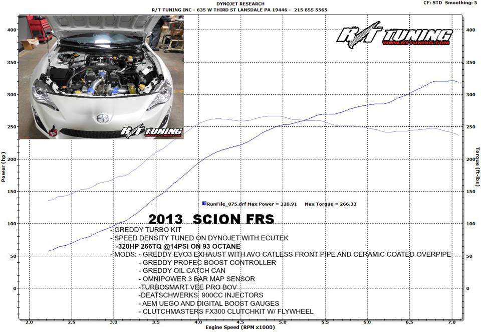

hey everyone, just wanted to share the results we had on one of our customers cars, all info listed in dynograph :thumbsup:

Great numbers!
We only have 91 in my neck of the woods, but I hope to hit similar marks on 91 with WMI.

great result.
when did full boost come in?
How much more room in this kit is there for bigger power?

@R/T Tuning What did you guys use to tune the car?

Looks like the graph says they used ECUTEK

you're right, thanks for pointing this out :)

ive got the same kit, hoping for around the same number when I get it dyno tuned

we are in the positive as soon as you accelerate, with peak boost around 3700.
as for how much room is left in this kit? not too much we feel, there are some gains to be had with e85, but this turbo is pooped at around 14-15 psi...we have tuned this same turbo for several years on honda applications and have seen the same results.
