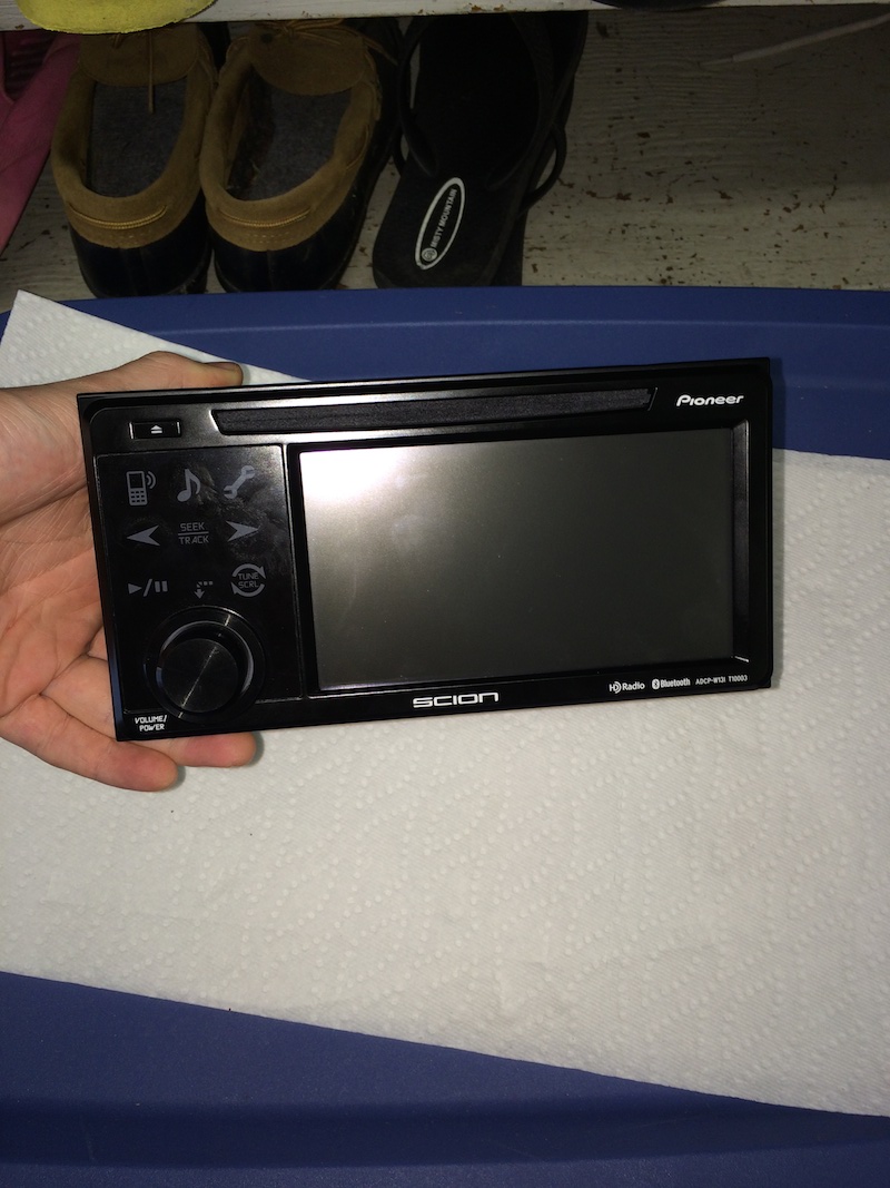

First off, I had the old Bespoke (canadian version) touchscreen unit installed in my FR-S and while it's good...I wanted better. Rear cam, DVD/video playback, GPS were all big for me as I spend a lot of work hours in my car.
Old Head Unit -->

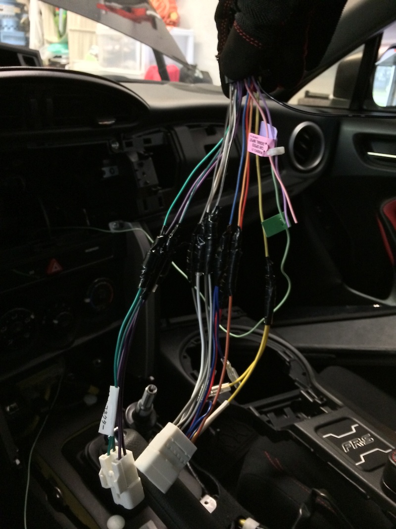

2. For help with wiring up the beat sonic, you need to know a few things. The POWER connector has all the bare wires coming out of it (as opposed to the ACCESSORY connector that has all of the red/white/yellow connectors coming out of it). Simply look at the Beat Sonic wiring harness wire colours, and match them up to the power connector wires. White goes with white, white/black goes with white/black, etc. Each wire on the Beat Sonic will have a bullet connector so you just need to add the opposite bullet connector to the POWER connectors corresponding wire, then crimp it to lock it on the wire. With male and female bullet connectors on each wire, you simply plug in the terminals and you're done.
Refer to this wiring guide:
http://www.beatsonicusa.com/Instruct...ual_En_BH1.pdf
That guide also shows you how to mount the beat sonic mounting kit onto the head unit. Keep in mind that it looks like the beat sonic kit goes on first followed by the metal bracket, but it does not. The metal bracket goes first, then the black mounting kit. Use the screws that come with Beat Sonic kit and your head unit, not the existing screws in the old head unit.
Here's everything all wired and ready to go:
Attachment 53388

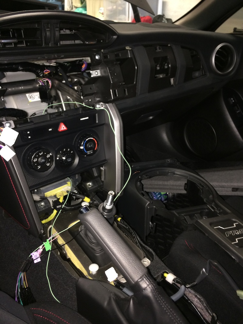

3. Now that the "hard" part is done, you'll need to take your console out to get at your E-Brake connector. To get that done, follow this guide:
http://www.ft86club.com/forums/showthread.php?t=15558
If you're having trouble getting some of the panels off (like the USB/AUX connection), follow this guide for help:
http://www.ft86club.com/forums/showthread.php?t=13583
**But stop before you touch anything to do with the knee pad as that is all unnecessary**
Here's what it looks like when all is out and console is removed:
Attachment 53390

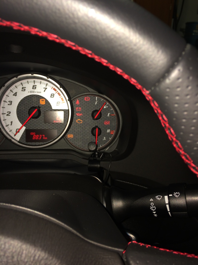

For the new mic, I decided against removing the A-Pillar and trying to get it up on the OEM location as I had complaints from people that it didn't sound great so I opted to go through the steering wheel column and mount it right by my engine temperature gauge. Looks very clean (as only I can see it) and functionally it is PERFECT. Sound quality is way better than OEM.
Here is the MIC location:
Attachment 53393

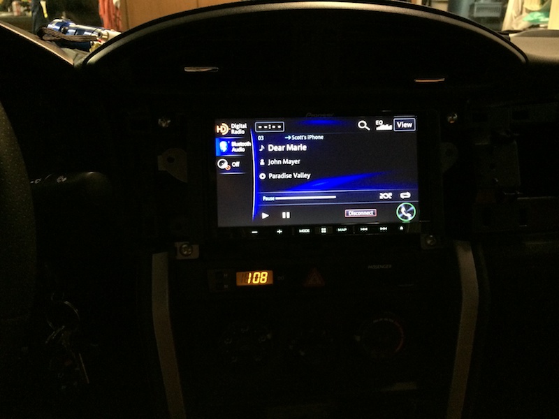

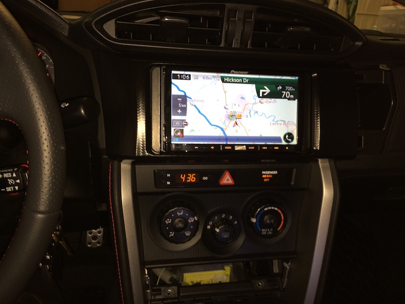

8. You're DONE! Make sure you zip tie all the wires into nicely packed bunches so that all the wires aren't getting tangled and stuff. Then just slide your new head unit back into the existing slots (making sure the black pegs on the bottom corners go through the metal bracket hole) and put all the screws back in and panels snapped back on.
Here's the final product:
Attachment 53394
Attachment 53391
