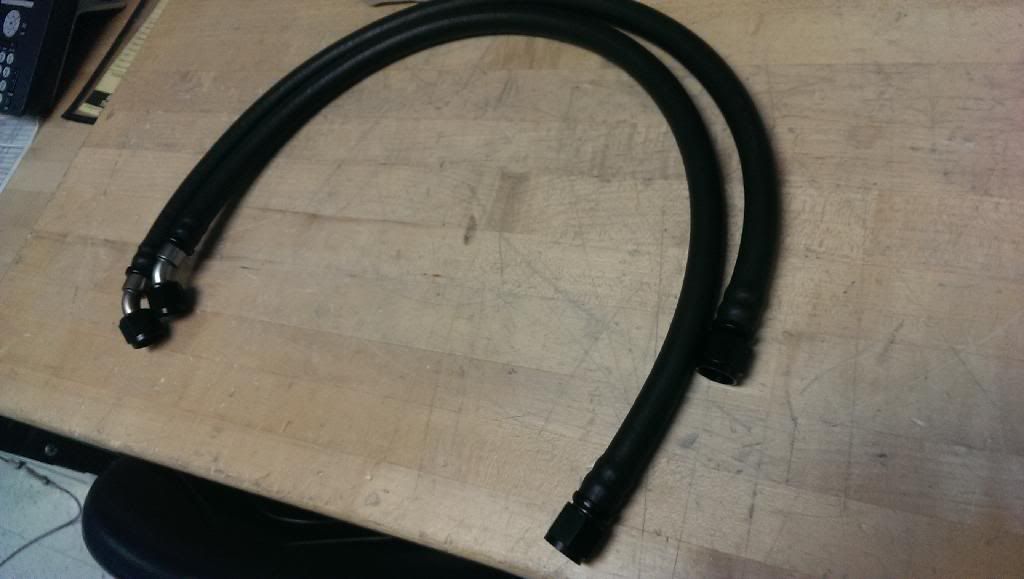

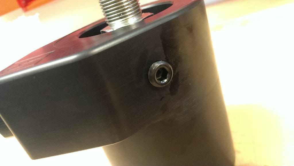

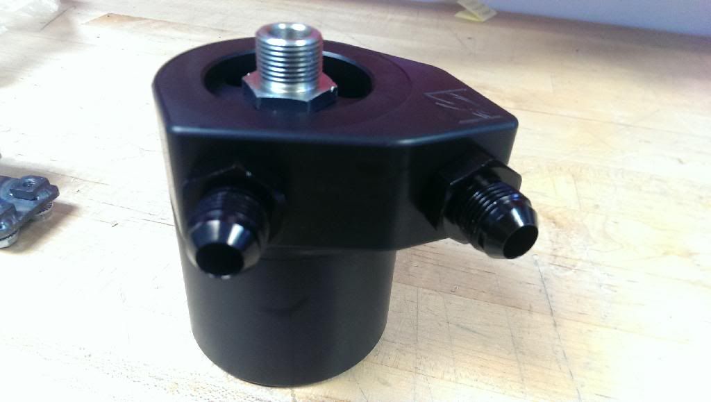

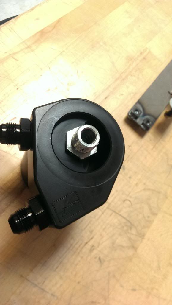

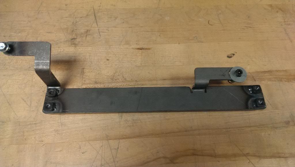

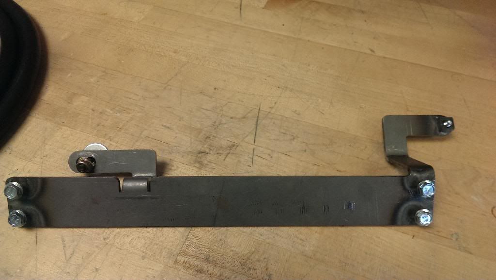

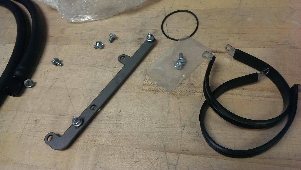

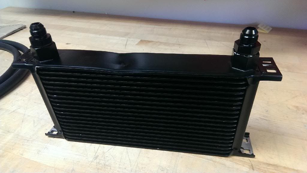

Okay guys disclosure: THIS IS NOT, I REPEAT NOT THE FINALIZED KRAFTWERKS BUT A PRERELEASED BETA UNIT THAT IS PROVIDED TO A SMALL GROUP OF PEOPLE. I'm sure the full production kit will have more powdercoating and will be "cleaner".
* Also, note there's a ding on the top of my oil cooler core, working with KW on getting another core but I'm likely going to pressure test it and throw it on if it checks out okay.
On to the pics, if you want more specific pics let me know. The threaded shaft I slid into the sandwich plate for picture purposes.
I'll get core measurements upon request.
Lines
http://i30.photobucket.com/albums/c3...psppuznkca.jpg

Core
http://i30.photobucket.com/albums/c3...ps2dqmsfif.jpg
http://i30.photobucket.com/albums/c3...psdpcceudh.jpg
Sandwich plate(love this piece)
http://i30.photobucket.com/albums/c3...psuc7f8hui.jpg
http://i30.photobucket.com/albums/c3...pswq5xdrqq.jpg
http://i30.photobucket.com/albums/c3...pscdnk4zvh.jpg
Main bracket to core
http://i30.photobucket.com/albums/c3...pshvakubyx.jpg
http://i30.photobucket.com/albums/c3...ps8kqlslzw.jpg
Other bracket I haven't looked into placement of yet and misc clamps
http://i30.photobucket.com/albums/c3...psebe9q2sz.jpg
glamcem 03-18-2014 03:25 PM
Thanks for the photos, is that a thermostatic unit?
OmarGC 03-18-2014 03:33 PM
Sadly, it is not. I'll probably look into an outside option before next winter.
