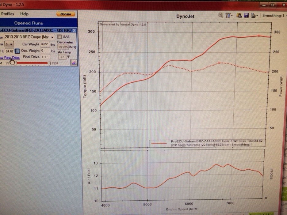

Scalzo 10-02-2013 10:49 AM
Attachment 52764
This help?
Sent from my iPhone using Tapatalk - now Free
Adeets 10-02-2013 10:53 AM
Holy shit lean.
Scalzo 10-02-2013 12:04 PM
Originally Posted by Adeets (Post 1246009)
Holy shit lean.
Thats what I'm saying...
Adeets 10-02-2013 12:12 PM
You need to contact your tuner, and get it to a dyno or street tune. That's unsat.
