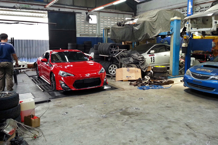

Prepping the car.
Attachment 52446
More prepping.
Attachment 52447

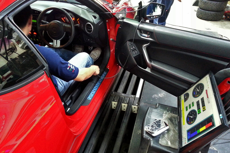

Is it lean enough?
Attachment 52448
The dyno master at work.
Attachment 52449

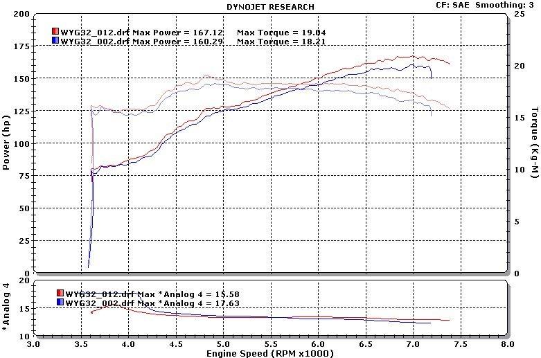

The Graph!
MODS: [RED 86 - MT]
- TRD Drop-In Filter
- TRD (JDM) Quadtip Axleback Exhaust
- Perrin (Catted) Frontpipe
As you can see, there's a slight increase in the peak power of around 7WHP but quite consistent across the entire band (from 3.5k anyways). The torque dip is still there but slightly better I believe. So am I happy? I'm not quite sure yet really since 7WHP is not a huge increase, but it's definitely there and the car does feel 'lighter' i.e. more responsive. It's a good thing but not a dramatic difference - will need to push the car further to see how good the changes are. Will wait till the traffic eases down.

after driving and punching a few FR-S, I can only say that missing feeling is well, due to the torque dip being partially corrected and the powerband being more linear now. Guess that since the torque uphill hike of approx. 20lbs.ft. in the short 500rpm interval was lessened and not felt as much as before. However, I'll take that usable torque anytime over the 5000rpm jolt. :)
