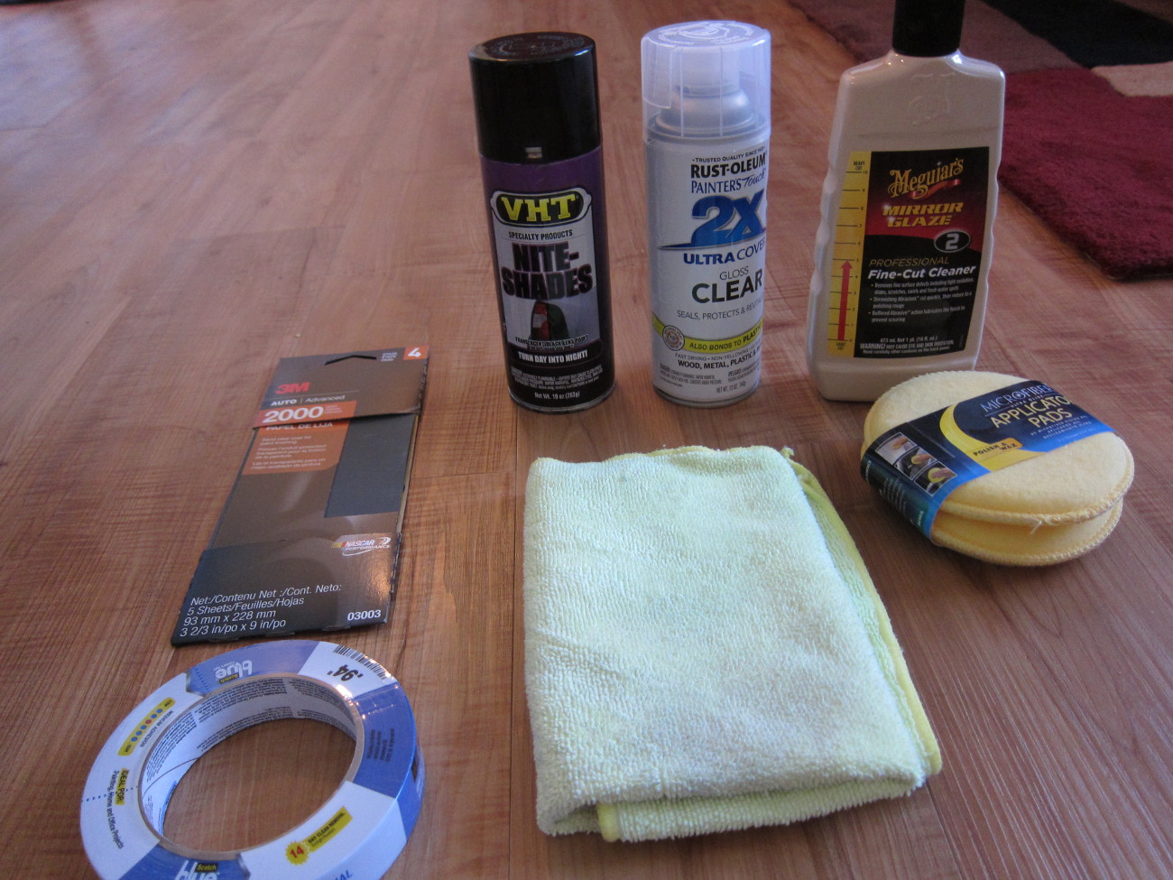

Tools needed:
10mm socket & 1/2" ratchet
flat head screw driver to pry off push latches
phillips bit for screw latches
2000 grit wet sand paper
blue painters tape
gloss clear coat spray paint
VHT Nite-Shades
wax
micro fiber applicator pads
microfiber cloth
dishwasher detergent
rubbing alcohol or paint thinner (I used rubbing alcohol)
Attachment 52166

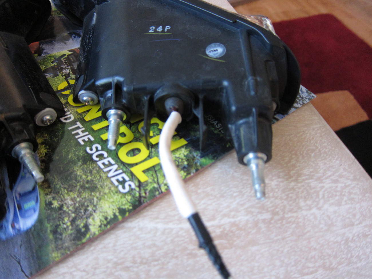

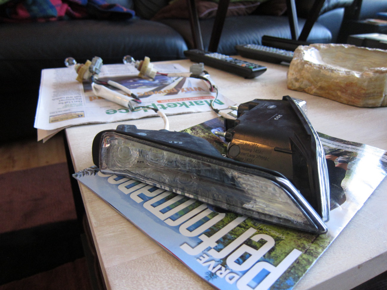

Once the cover is off, each DRL is attached to the cover via two nut/washers tightened on studs. You can see these studs on the DRLs pictured below.
Attachment 52165
Attachment 52163
Once the DRLs are detached, the fun begins.

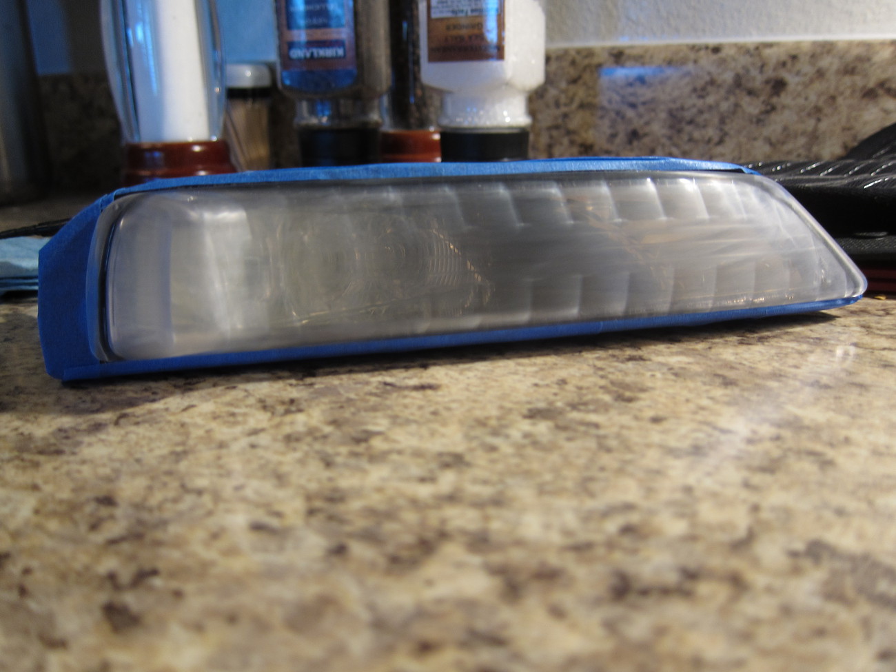

Step 1: In order for paint to adhere to the DRLs it was necessary to rough up the DRLs with a light sanding. Using a little detergent on the wet sand paper, I sanded the DRLs until they were cloudy. *Clean with the rubbing alcohol or paint thinner to ensure surface is clean prior to painting!*
Step 2: Then I masked off the parts I was not interested in painting with painters tape; to exercise an overabundance of caution I also covered with painters tape the plugs and foglight bulb assembly that are attached to the DRLs and not detachable.

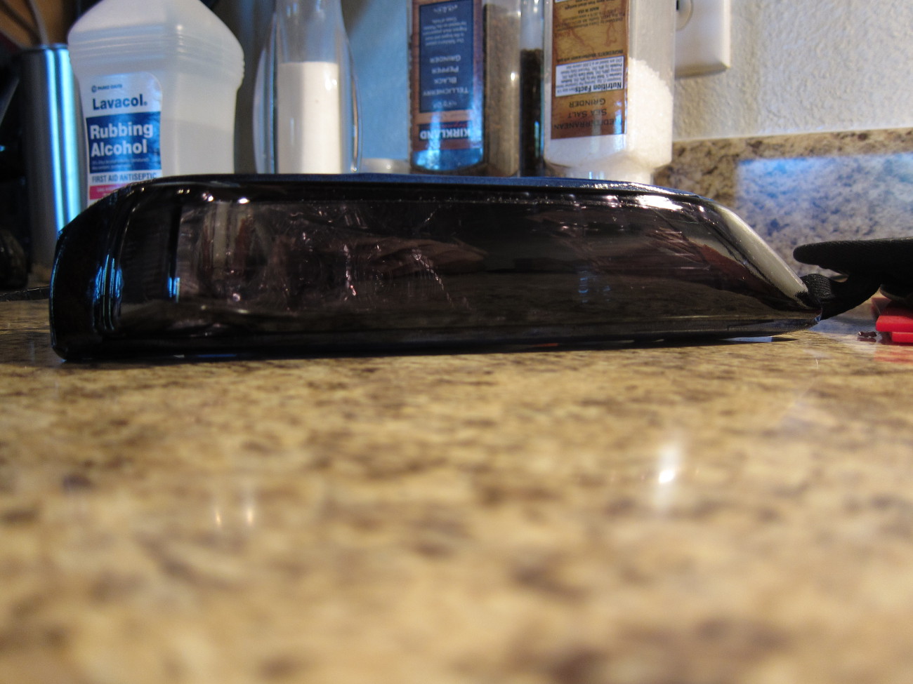

Step 4: I should have waited an hour and then done a light sanding before adding clear coat, but I didn't. I applied four coats of Rustoleum Ultra Cover Gloss Clear. Then I let them sit for an hour. Below is a picture after this step.
Attachment 52168

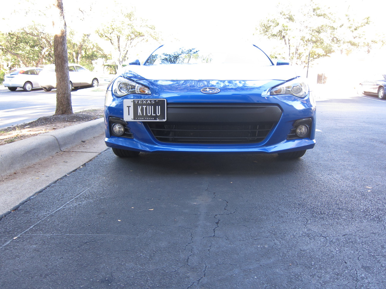

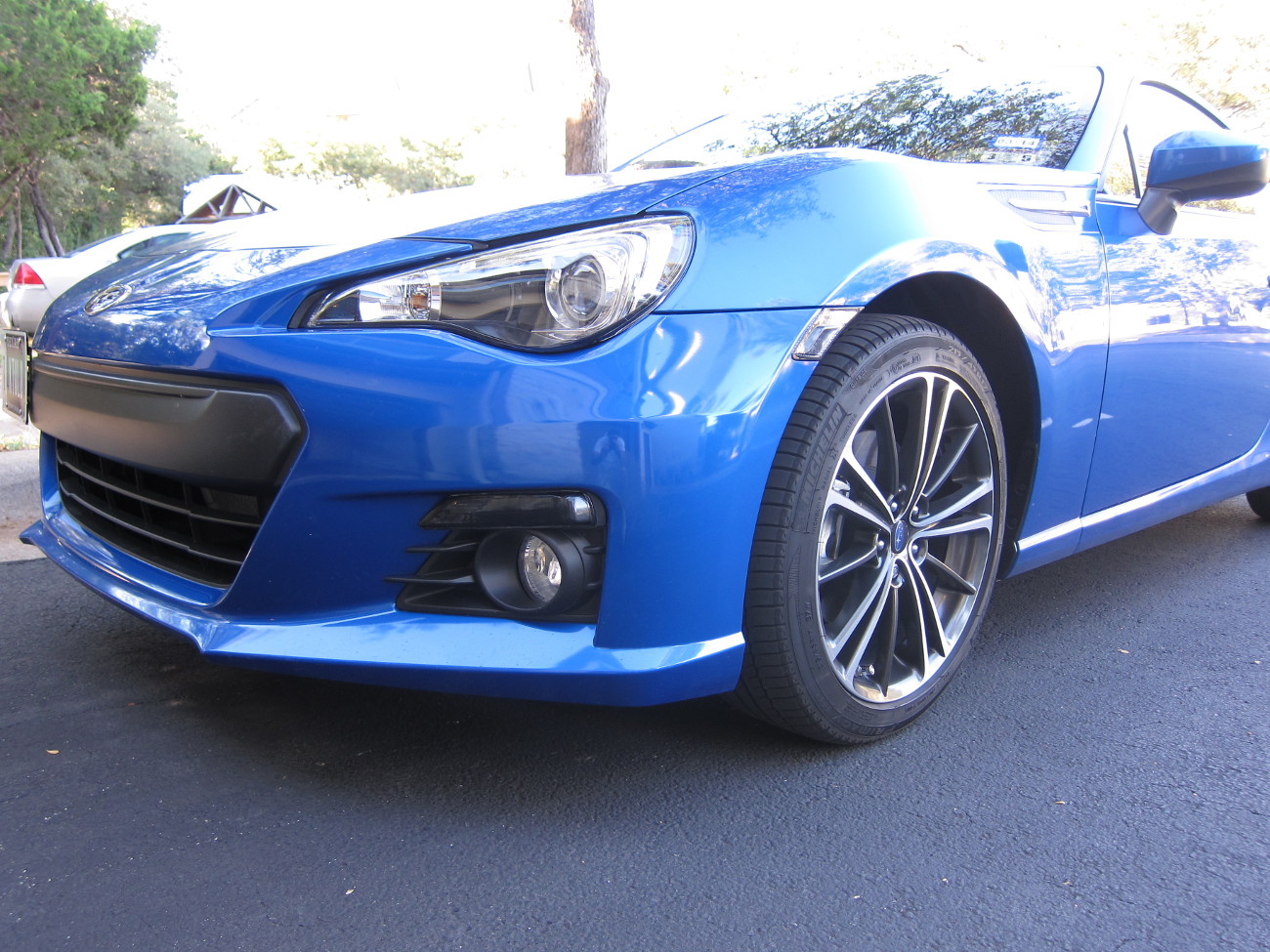

And for SnG's here is a pic of C'thulhu running around naked.Attachment 52173

Turkish 09-25-2013 09:40 AM
2 Attachment(s)
They look like they've lost about 10-20% brightness.
