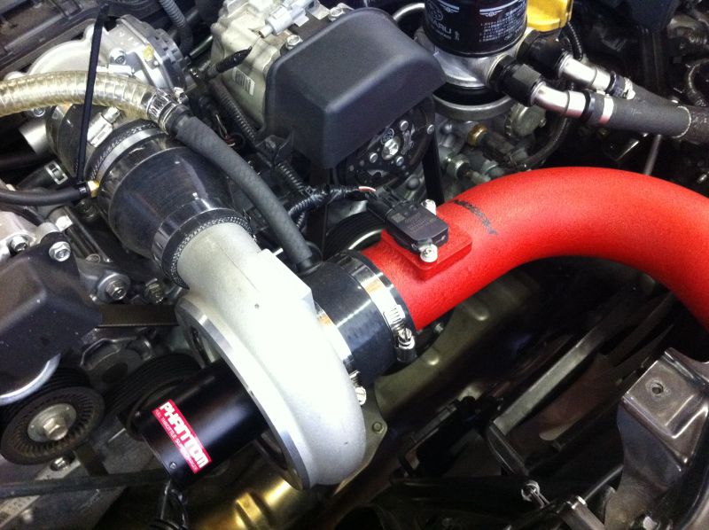

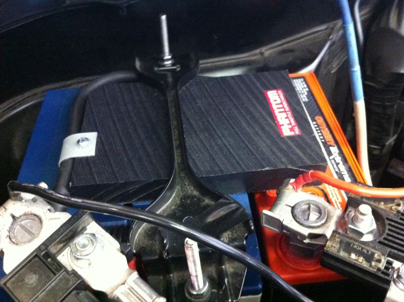

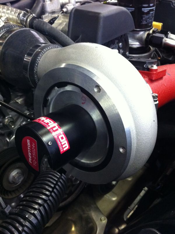

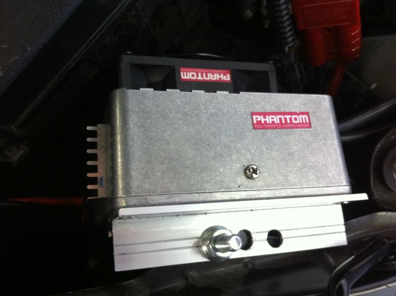

>>> Insert Phantom ESC Pics <<<
Attachment 51643
Attachment 51644
Attachment 51645
Attachment 51646
Benefits? From the pics above, everyone should notice one key difference between the Phantom and the likes of say, a typical SC product – there's no belt driving the SC unit. This means that the system is non-parasitical in nature. The engine isn't taxed by any pulleys or belts holding it back. Unlike some 300 crank HP SC units that require up to 45+ HP to drive it, there's nothing to restrict (and I use this loosely in this context) “boost” in this case with the ESC.
