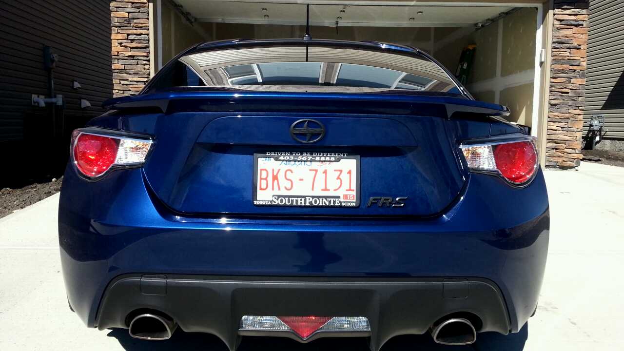

kALMIGHTY 09-20-2013 04:31 AM
Nice work! I did the same thing recently. No staining on mine either.
Attachment 51816
