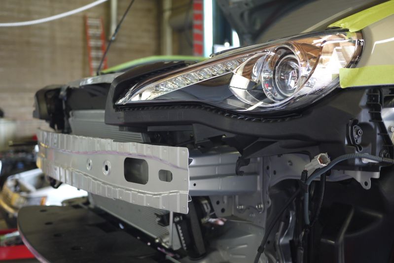

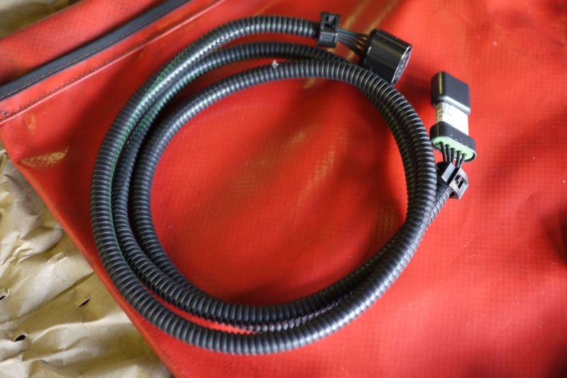

^^^ This is new... a professionally built harness, built to spec - as opposed to extending and soldering wires...

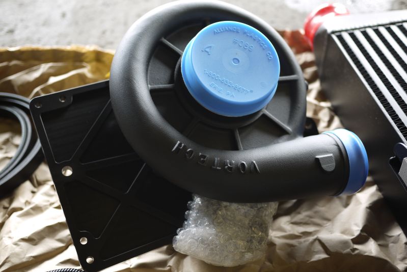

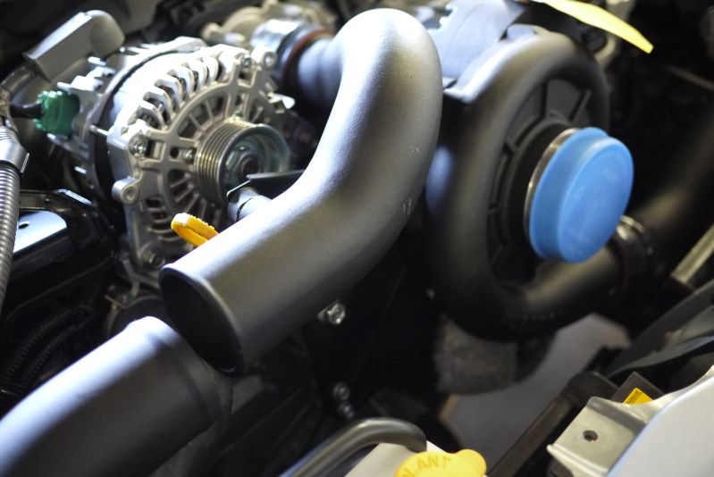

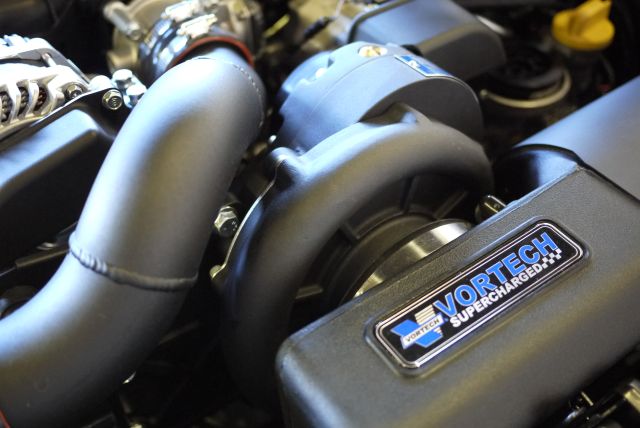

So not having any real issues on the first install, especially when lots were complaining about clearances and fitment, I had figured that this one was going to be cake.
I thought wrong.

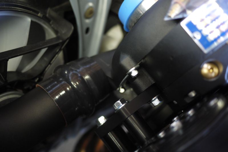

Attachment 50152
Attachment 50153

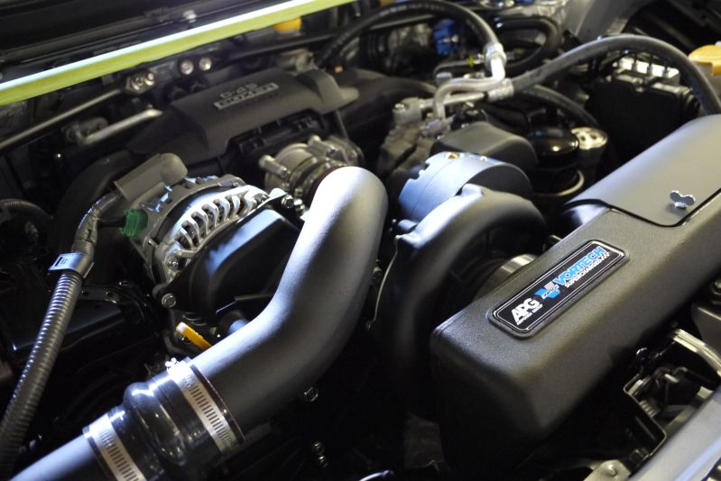

Anyone notice anything in the pics? It might be hard to see in the first pic but the charge pipes don't line up exactly like they used to in the earlier revision. It would appear that the SC unit is clocked ever so slightly but enough counter clockwise...
In the second pic, the pipe doesn't even line up and there's no way to do so since the mounting bracket is in the way. Why is it so different? Bill had quickly noted that that section of pipe is now CAST and is different from the previous builds (3 piece welded pipe) and there's no way to fit this unless...
Drift-Office 09-03-2013 03:25 AM
7 Attachment(s)
So this was what that section of pipe looked like before :
Attachment 50160
This is what it looks like now :
Attachment 50155
Attachment 50154
^^^ What we had to do was to grind down one of the brackets to gain enough clearance to not touch and still be able to line it up... Not sure what happened there but we'll be calling Vortech's Tech Support to see what they can do for the customer here on this one.

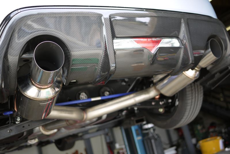

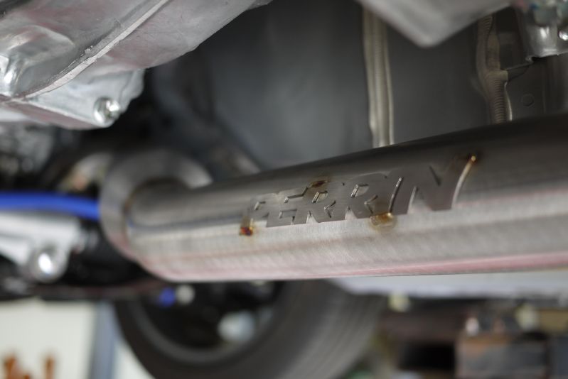

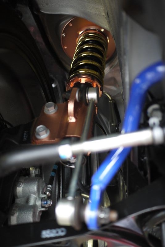

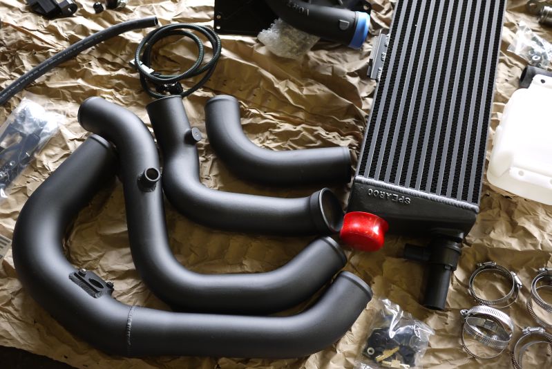

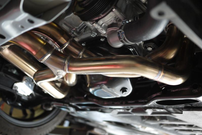

And finally, here are some of the other products that were installed...
Attachment 50156
Attachment 50157
Attachment 50158

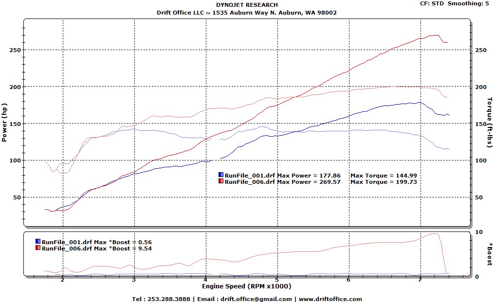

Overall, everything came together nicely sans that one pipe. And the results? Let's just say that while the HKS EL unit did help right at the very top, I'm not sure if it's worth the extra $1100+ .
The results are really nice and clean, as evident in the accompanying dyno graph! Note that the baseline indicated in this chart is of the same vehicle with the HKS EL header installed but without a tune!
Attachment 50159

Very nice. Lower numbers then expected. Oh well.

What were you hoping for? 290 on "pump gas"? *chuckles* :) Yeah, I would have hoped for more with the HKS EL setup but it didn't do merely as much as I had expected sans at the very top end.

oh, and a question. So vortech now sends out a kit with a pre-made wiring harness to replace the DIY job you had to do before? If so, good news!
Rick@Vortech 09-03-2013 06:20 PM
I'll present this to the rest of the team.
Yup! The MAF Extension Harness is now included in our kits. No more need for cutting & soldering. :thumbsup:
pheoxs 09-03-2013 06:20 PM
Originally Posted by SkAsphalt (Post 1186655)
a 100 whp boost basically .... I love it.
That they do, mine came with it as well a few months ago. No more soldering wires its just plug and play.
