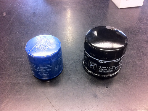

It's definitely not going to be the M108, the new style filters are much larger than the old ones, which themselves are much larger than the M108.
Shitty old-school Honeywell (Fram) blue OEM EJ filter next to a shiny, well made Tokyo Roki OEM FB/FA oil filter (PN: 15208AA130) in Black .
Attachment 5813

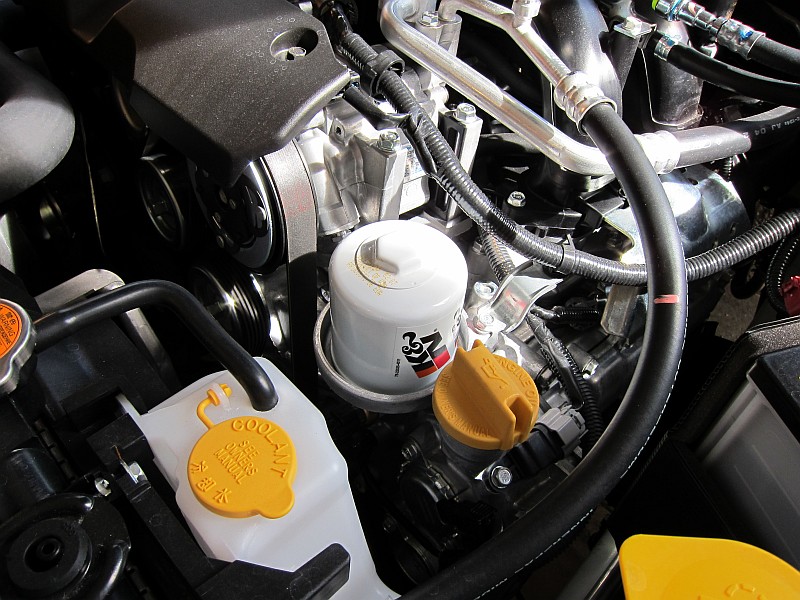

And while I was digging around, I found this. It's an FB25 with a K&N HP1004 (equivalent to an M104).
Attachment 5814
That said, you're probably better off sticking to the OEM filter once you use up your stash of M1's. Tokyo Roki makes high quality filters and Subaru specifies a stupidly high bypass valve pressure, meaning that aftermarket filters will be allowing a lot more oil to bypass the filter element than Subaru recommends. The Tokyo Roki OEM filters are valved to Subaru specs, are very solidly built and they're only ~$6.50.
