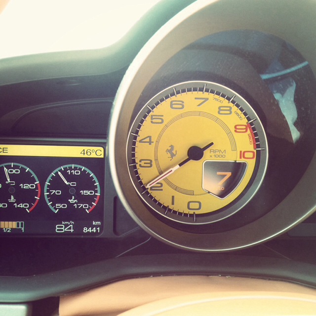

SmsAlSuwaidi 08-18-2013 01:23 PM
Our middle eastern climate sucks ass in summer :) you guys in the rest of the world can't imagine how bad it is !
Attachment 48396
This was yesterday , about 115f (46c) a normal summer day :(

SmsAlSuwaidi 08-18-2013 01:29 PM
@Djen even the cars AC can't blow proper cold air out haha !
Dipstik-sportech 08-18-2013 01:30 PM
Ok it can't be that bad when you're sitting in a Ferrari 458. For the cooling issue I'm going to try a better more powerful fan on the turbo side. I think the issue is two fold, the fans in the kit are adequate for more temperate climates but can't move enough air when it's that hot. Also these cars don't have a lot of under hood venting, meaning there's nowhere for the hot air to go and this it heat soaks. Time for a vented hood lol
