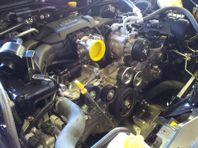

^^^ Vortech has included 3 extra bottles of SC lube, and included more in the SC unit itself. First change @ 2500miles, then every 7500. Extra lube can be purchased approx @ $30 for a set of 3. I guess it would be ideal to change out the lube every time you do an oil change. Now the supplied 2.5 bar map sensor didn't come with any calibration specs, and when given the specs by OMNI, I didn't feel that they were close to where they should be so I elected to use one of our 3 bar sensors instead.
Attachment 46237

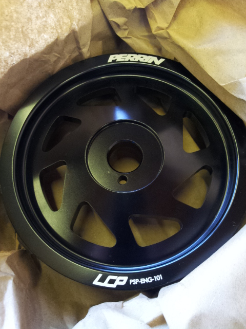

^^^ The customer wanted a pulley setup and that was probably the first thing that was installed.

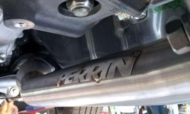

^^^ Along with the build, I had recommended the use of Perrin's overpipe, catted frontpipe and a 3 inch resonated exhaust. All of which fit PERFECTLY. I have to applaud Perrin for their nice thick flanges and V-Band setups. I'm big on those! :)

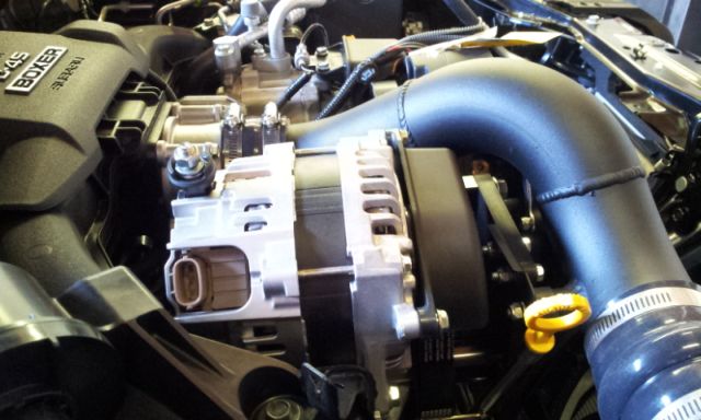

As it turns out, there was plenty of room for everything. Some spots were tight but there was certainly zero contact even with the hood being dropped at height...

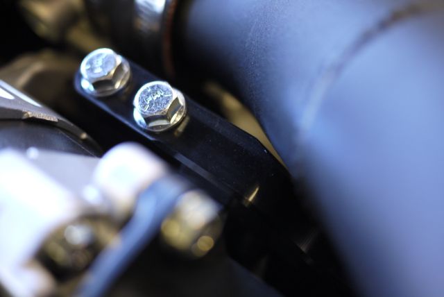

At this point, just about THE ONLY ISSUE that I agree 100% on and see are the wing nuts that keep coming loose! I was looking for a solution to keep them in and subsequently prevent the filter intake cover from coming off when a solution presented itself! We used one of the oil cooler lines to wedge the cover in place so that it wouldn't come off. Sure, the wing nuts would rattle but the the crux of the problem is now secure...

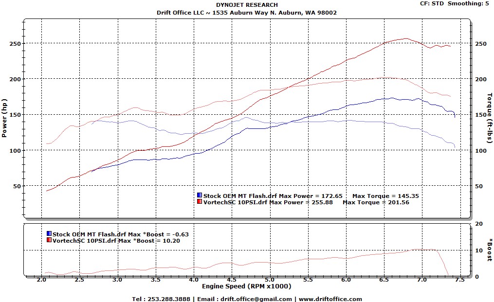

So without further ado, here are the dyno numbers...
Keep a few things in mind here :
1) STOCK OEM Header (with Cat)
2) 2.5 Inch CATTED Front Pipe
3) 92 OCTANE Chevron Gas
Attachment 46256
^^^ That's our "default" Vortech map. It's not bad though it's clear on the logs that it's even more octane sensitive the way it is being FI and all, and you can see a little relaxing of timing past 6900 rpm here. Still, quite in line with what we've seen from previous dyno charts with 93 octane, and even smoother too. ;)
Attachment 46257
^^^ Looking at the logs from the map before, it was evident that more timing could still be added, multiplier and knock correction were happy and without issue so we decided to add more timing and that was the result... Nope, it's not belt slip you're seeing (in this case) and while there was zero knock on the logs, it was pretty clear that it wasn't as happy and more timing was pulled from the top. Still, @ 267WHP / 205#s TQ, that's pretty nifty!
^^^ It should also be noted that both runs were conducted back to back, with about 30 seconds (ish) of cooling time in between and the more aggressive map certainly shows apparent signs of heat soak...
Attachment 46258
^^^ Finally, here's what the lower run looks like when compared to a typical 6MT baseline ~ product is as advertised!:clap:
