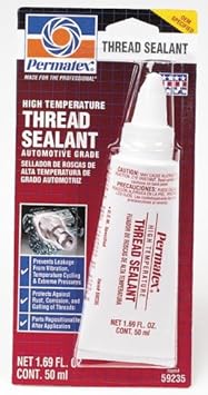

The oil line that goes into the top of my turbo leaks oil. Not a lot but enough I can smell the oil burning off the turbo at red lights. I have tried tightening it but it feels pretty tight already. My question is how tight is that bolt designed to be. Am I in danger of damaging the fitting if I really put some force into it. I guess my other option is removing it and putting Teflon tape or something on it. Suggestions?
M1K3 02-20-2015 09:44 PM
I used high temp thread sealant:
http://ecx.images-amazon.com/images/...YL._SY355_.jpg
robr 02-21-2015 12:35 AM
Do NOT use Teflon tape on any part of the oil feed line. Use a liquid sealant like pictured above if you feel the need.
But, the supplied fitting is ><just too long for the block and bottoms out before it crushes the crush washer. You'll want to pick up a fresh pair (two, 2) of crush washers, pretty sure 1/2" is the size you want...pull yours and match it up best you can. I suggest two new ones, but I can almost guaranty that the one installed right now has no sign of use so you might be able to get away with reusing it. But they are so cheap I wouldn't bother. Without replacing the restrictor with a slightly shorter one, the double crush washer method is seemingly the best solution I've found so far.
kbogarto 02-21-2015 06:25 AM
Awesome, thanks for the advice I'll do that.
