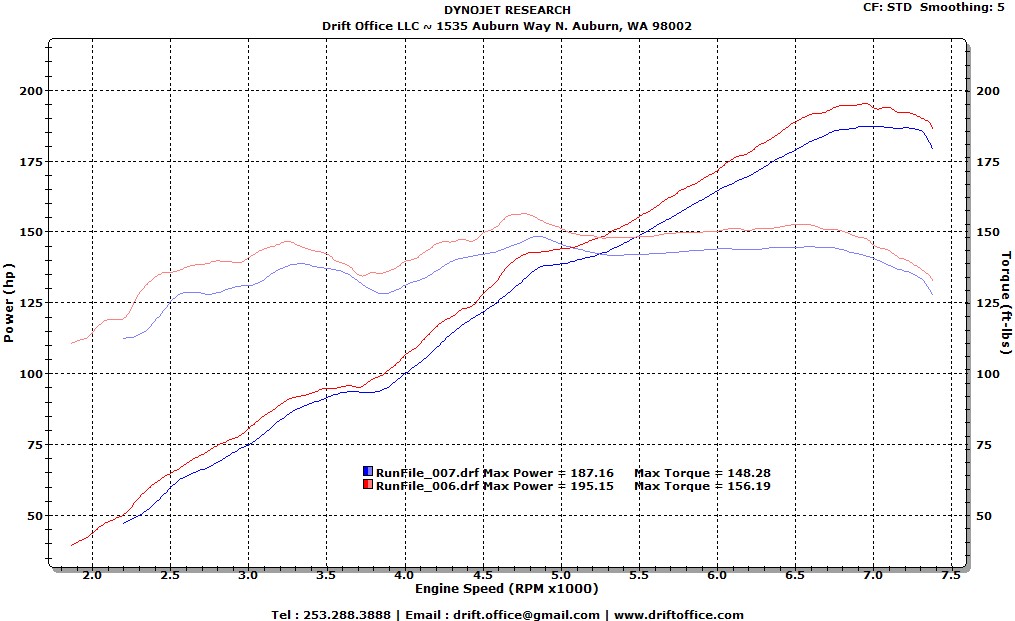

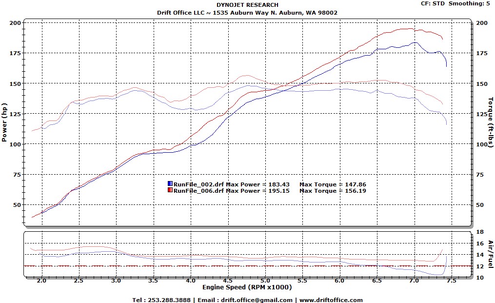

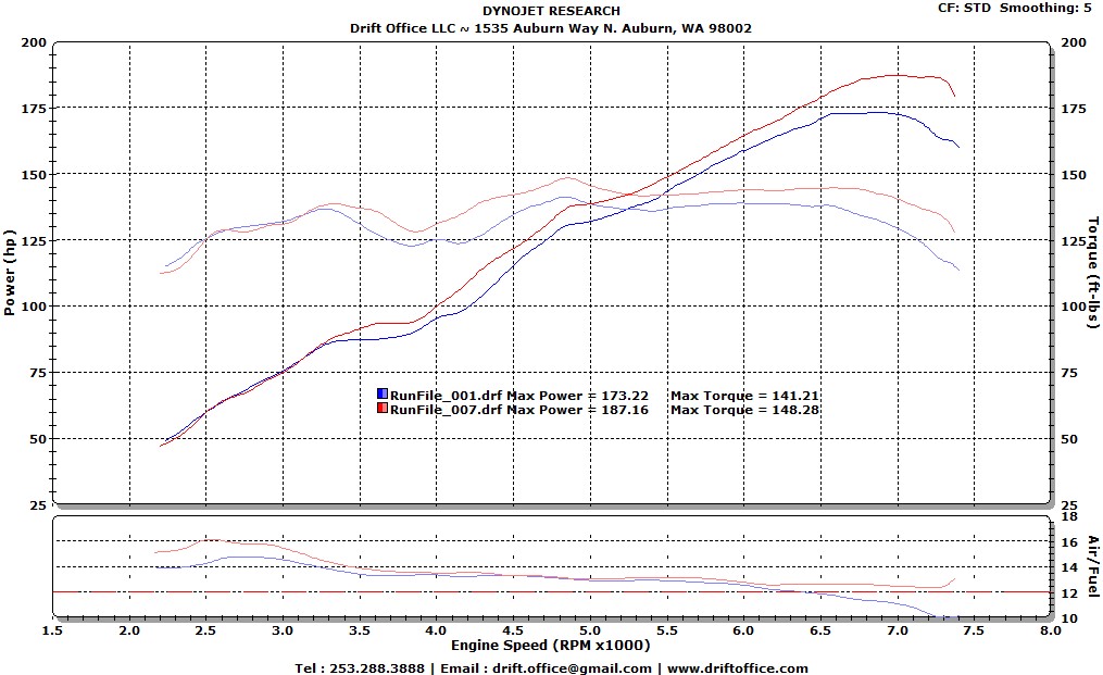

Jumping straight to the results, here are his 3rd & 4th gear pulls respectively, each sampled before and after the tune...
Attachment 43943
Attachment 43944
Attachment 43945
Not bad ~ a few HP shy of the magical 200WHP, but there were a two factors that had contributed to that ~ HEAT and secondly, MAF turbulence caused by the intake. In the many, many FRS / BRZ setups that have come and gone thru my facility, I have noticed that you would be hard pressed to get a better intake than the stock. Granted that it doesn't look bling enough for most, it really does well when it comes down to it, especially if you're planning to tune it down the road.
That said, I'd like to think that we did a pretty good job here given the minor complications and yielded highly positive results.

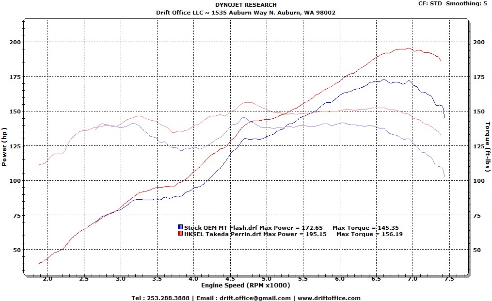

So here's what a 100% stock setup vs this HKS setup looks like...
Attachment 43949

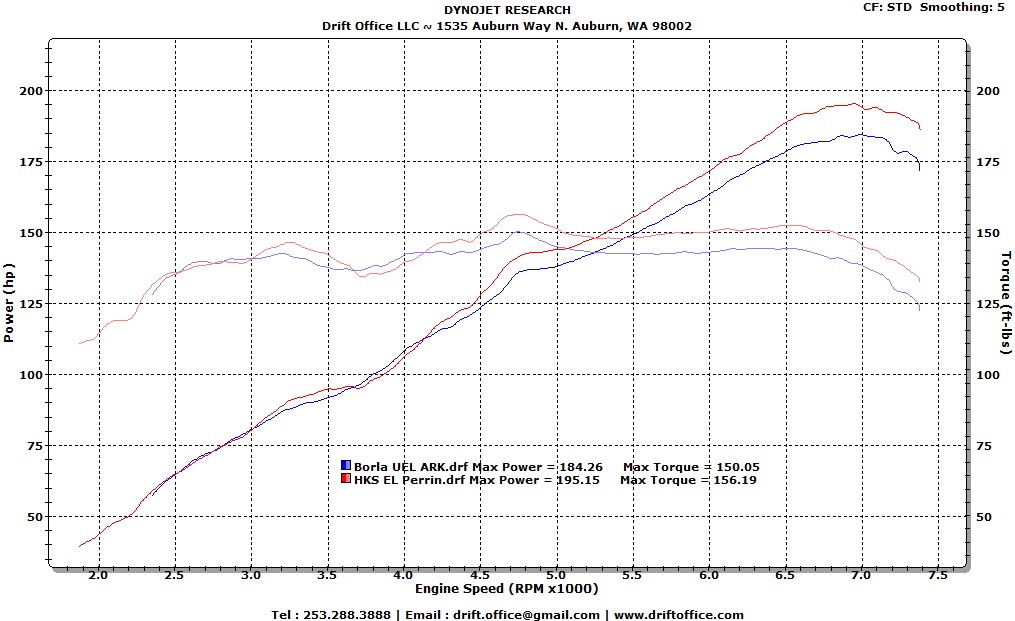

And for those who are undeniably going to ask...what does this look like against the BORLA setup? You decide...
Attachment 43950

Nightbringer 07-13-2013 07:30 PM
Nice pulls! Thanks for the comparison
Esoteric 07-13-2013 07:43 PM
Interesting results!
It would be even better to see them back to back, identical setups... But it's good at least they are both on your dyno.
What do you think? Very close when actually on the same car, same intake, same temps? Small edge to the HKS?
Drift-Office 07-13-2013 09:40 PM
One had a stock, the latter has a Takeda intake which did nothing but hurt the possibilities IMHO. Both were temp corrected when I used the applicable correction factor but it's pretty apparent that ELs typically make more power than UELs. But I suppose some would prefer the UELs since it might be more acoustically pleasing to their ears. :)
Cheers!
Bob @ Drift-Office, LLC

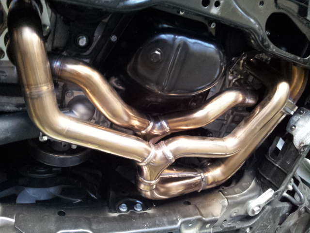

Hey bob the hks header that you tune was it the catted version?
Drift-Office 07-14-2013 12:52 AM
Negative! Let me get a pic up for you...
Attachment 44005
I do have another CATTED header / setup coming my way from Asia, not sure how well that's going to be either, but stay tuned as always! :)
