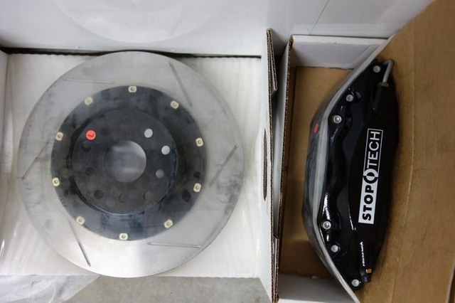

omgwtfbbqsauce 07-09-2013 04:41 PM
Yep I have gotten a very good deal for these ones specifically, these rotors are multistud too so of anyone can answer this quest, would be great. Thanks
Attachment 43526
Xauterus 07-10-2013 04:24 AM
Should fit on since Brembos from that age wrx fit on an 86. You may need to swap the calipers from left to right and move the bleeders and cross pipe if they have different sized pistons.
No Limit Motorsport 07-10-2013 08:10 AM
You can print a paper mock up of the brakes from Stoptechs website to see if they will clear the wheels. We did this with a local customer with his kit.
OrbitalEllipses 07-10-2013 09:42 AM
Bleeders and crosspipe would be better than going from left to right; they accomplish the same thing (moving bleeders to the proper orientation) BUT swapping left to right will probably give you weird pad wear if the calipers are differentially bored (which they very likely are and I'm not about to check).
Xauterus 07-11-2013 05:43 AM
From other pics i have seen of the StopTechs they are staggered size pistons, so you will need to swap the sides. Should be pretty simple.
