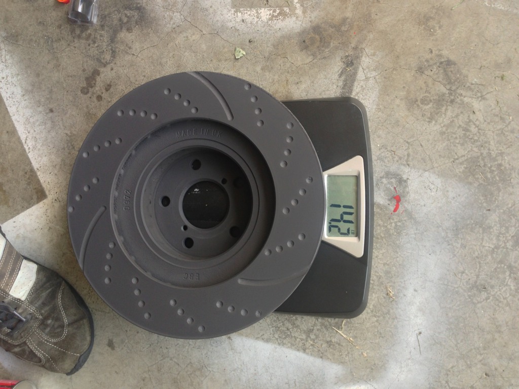

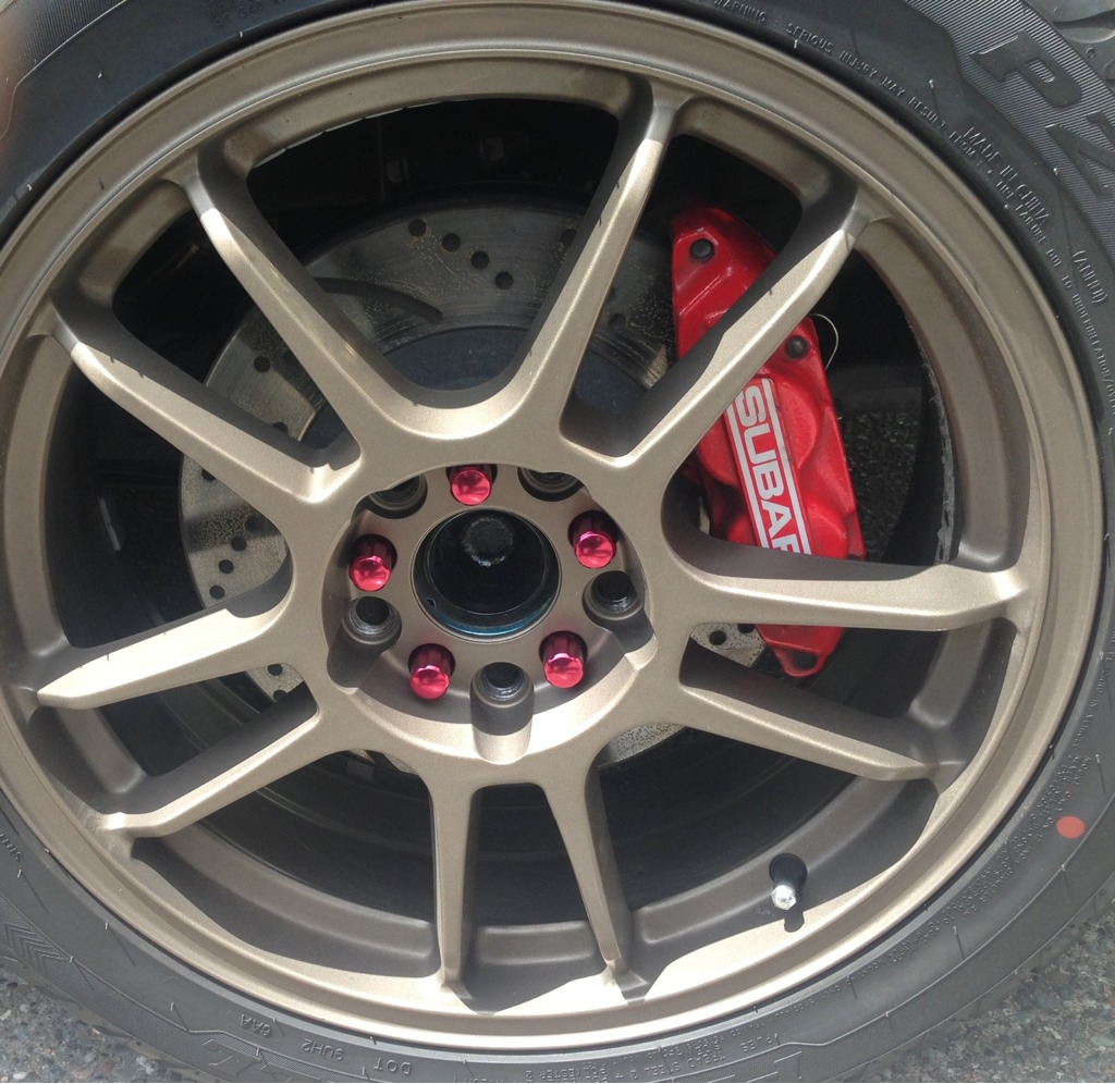

So I was lucky enough to get a great set locally here in Tacoma. They are in great shape with only minor chips and scuffs. I went with these over brembo because I wanted to keep 17in wheels and I think the Subaru logo is way cooler to put on the Brz.
The fronts fit perfectly, I have 17x7, +42 Tenzo R wheels and there is clearance for days. Bolts straight up using stock bolts.
The rears are a little less direct swap, the sti rotors don't work with our ebrake system. Our ebrake circumference is huge in comparison. Also gonna need some brackets for them to fit.

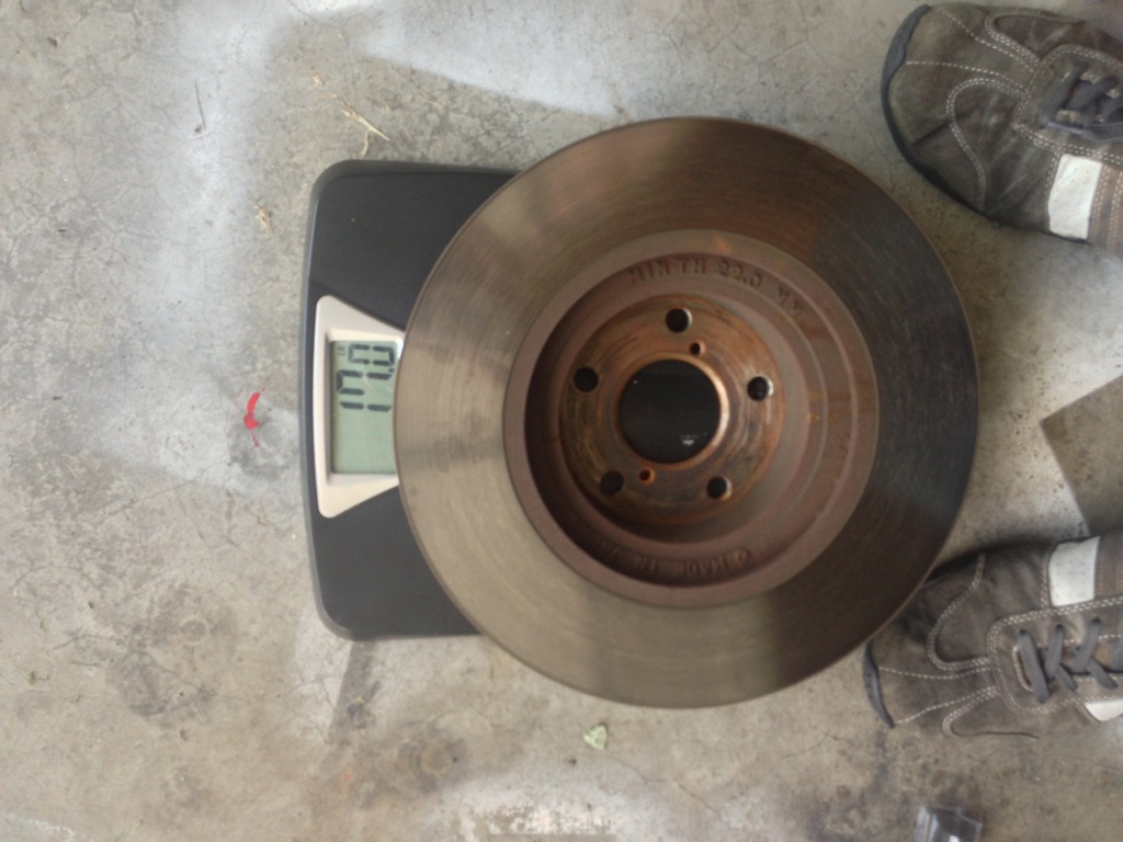

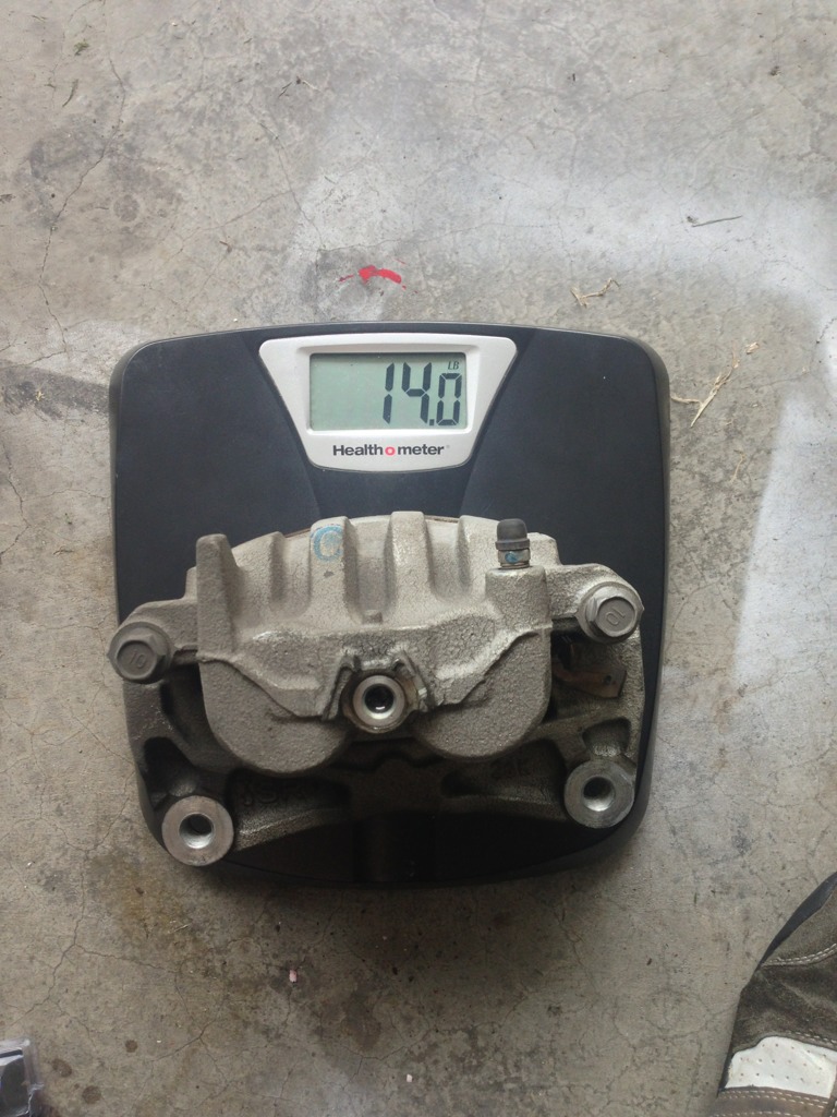

The weight difference on the fronts are pretty good also, 11.8lbs for the 4 pots and 14lbs for the stockers.
The overall rotor diameter is the same on both front and rear, as with the rotor width. So in theory, you could use stock rotors with these brakes.

Wonderbar 06-17-2013 04:04 PM
The rotors on the rear are the same diameter. Needs brackets to mount the calipers. Wrx rotors won't work due to ebrake. Driving, will post later

No bracket. Mounting ears are the same distance as the dogbone bracket for our sliders.
LeeMaster 06-19-2013 10:42 AM
For the people who says rotors dont matter, IT DOES. Just look at the weight difference, it reduces rotating mass and has the same effects as going with lightweight rims. With that being said, I might consider these, I cannot believe I passed on these when I found a fresh 06 WRX at the junkyard. DOH!
