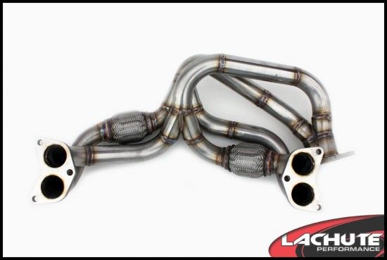

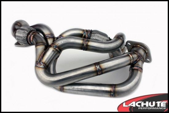

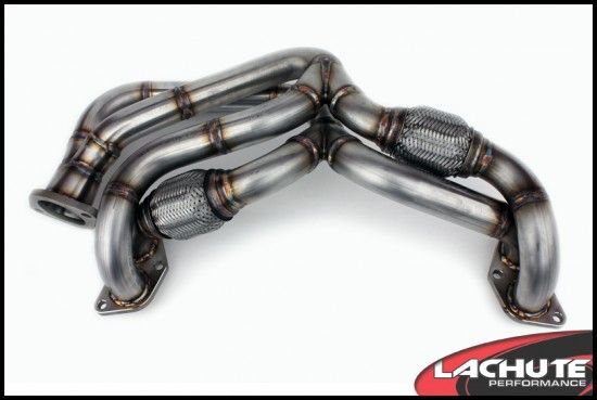

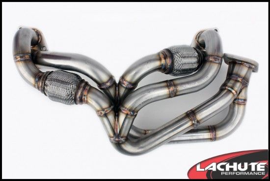

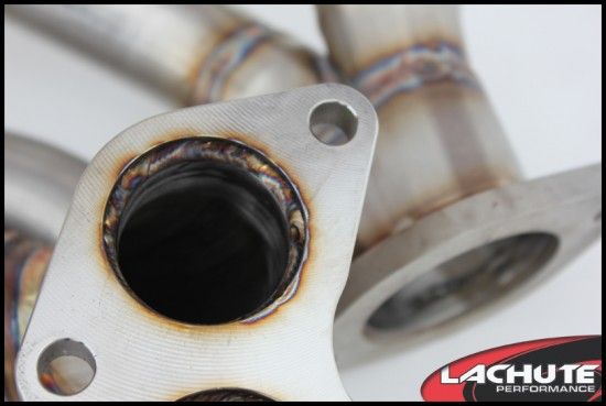

OICU812 06-27-2013 02:10 AM
The new Lachutes look interesting and well made.
