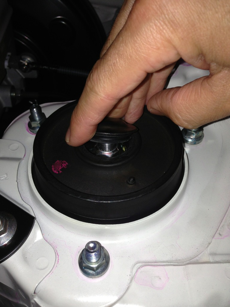

I had my Koni front struts blow on RCE Yellows after about maybe 1k miles. Will check with the shop that did the install to see if they'll warranty it or if Koni will warranty it, but I'm stumped. The Koni's seemed like a great product, and I can't believe they failed. They were at half turn from full stiff and installed by a reputable local shop (Works).
Driver's side strut appears to be ok, if you push down on the top-most rubber nib on the top mount, it's completely dry. Passenger side is still leaking fluid.
Are you not supposed to use stock top mounts with the Konis? What do you guys think is going on? I haven't touched the struts since the install.

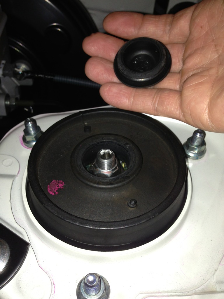

Can you pull that rubber top off and give us some pics of inside?

Love Koni's. I ran them in my M3 and LOVED them. You might not be able to run that top rubber piece with that tab. Can you post pictures without the rubber cap? There isn't a lot that can be installed wrong on them, so I would bet product failure.

These are the stock top mounts, I don't think the top part can be removed, although I'm not an expert at suspension so I'll check it out tomorrow.
simpleisbest 06-10-2013 11:36 PM
They look installed correctly. The part where the shock is protruding is the rubber cover that covers the top nut. You can peel that off to reveal the shock adjuster. Looks like shop poked a hole in the cover to allow the adjuster to poke through while protecting the top mount bearing from dirt and dust. Nothing wrong there. Best find out if both fronts are leaking before contacting Koni.
suaveflooder 06-10-2013 11:37 PM
3 Attachment(s)
Originally Posted by vubaru (Post 994446)
Funny thing is I loved these at first then the ride quality started deteriorating...hmm..wonder why!
I bought them off a dealer on this forum so I'll contact him first then take it from there.
Here you go. Now go take us pics ;)

vubaru 06-10-2013 11:47 PM
Duh...easy enough. My crappy cameraphone doesn't have a flash so I'll take some tomorrow.

OrbitalEllipses 06-11-2013 12:37 AM
When you get the strut top off, look at the washer at the base of the adjustment blade. One of my struts was leaking from the adjuster out of the box because the o-ring seal beneath wasn't seated. Koni warrantied the strut, but took their sweet fucking time.
