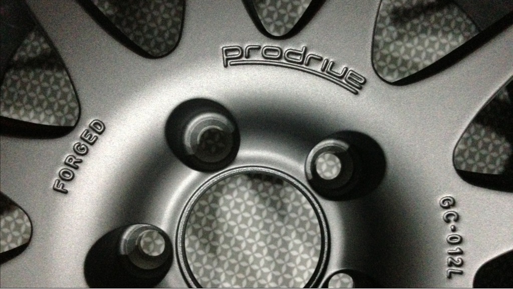

typericey 06-08-2013 09:21 PM
@Steve, thanks for your response
@Ro_Ja If I immediately tell you what Prodrives they are, where's the fun in that? :D I'll keep it a mystery for now. Would you mind telling me what you ordered and what specs?
@switchlanez yes, Prodrive is really not the best choice for that flush/stanced look because their usually flat. They're best tucked in just a bit, and that's partly the reason I chose a relatively conservative 8" width and +45 offset. I also figured they're the best compromise between form and function. As it is I'm still worried with how these wheels will alter driving feel.
I was informed by the local distributor that that Prodrives are hard to come by as they are now on a made-to-order basis. If you wanted a specific size, you will have to order and wait 90 days. In fact, some models and specs in the Prodrive-Japan website are said to be discontinued. I was just lucky that the model I wanted was in stock.
Here's another teaser, lol.
Attachment 40172
switchlanez 06-08-2013 09:49 PM
^The code gives it away lol...
