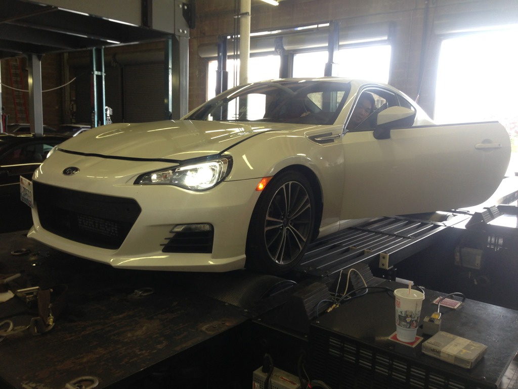

This is my initial review, report and dyno for my vortech supercharged BRZ running on a Perrin tune.
Go fast mods:
- Vortech standard kit (9psi)
- Perrin tune
- Perrin 2.5" catted/resonated header back
- Perrin crank pulley
- other mods won't affect hp
- still on stock tires
First off, I'd like to introduce my brand new brand name "driveway performance laboratories", which I thought appropriate to label my mechanical activities. Secondly, I'd like to make it known that I violated everything Jeff Perrin asked me not to do in the first week, since he is making sure my tune is dialed in remotely. Sorry Jeff! It's like telling someone "don't push that red button".
Starting with purchase and install, the guys/ladies down at Perrin are hands down amazing. The most humble and welcoming group I've met in a long time. Jeff personally talked me through some quirks of install and tips, since he knew I would be tackling the install myself and it was my first go at it. They are more interested in getting the product out on the street than trying to take all your money, and the deals the offer will continue to amaze me since I know the rent for the shop must be killer. (The effing shop is huge and one of the cleanest/nicest I've seen.).
The install was super easy, great PDF from vortech. I literally did it myself, in my driveway, no ramps, no lift, no special tools. Just a 3/8th's drill for mounting the IC brackets and a ratchet and wrench set. From first bolt off to complete and driving to get gas was right at 10 hours, but there were multiple breaks for Facebook and chasing my 1 year old, who kept stealing hose clamps. ANYONE, ANYONE, ANYONE can install this kit if you can count, measure and know your left from your right. Perrin, vortech, and myself all are willing to talk you through things via phone or email if you get stuck; however, no one can assume responsibility if you screw it up.
The kit is great! Super clean parts, a couple bits that I think could've been done better, which I have already raised the point to vortech, hopefully they follow through.
Initial driving, amazing, it is smooth like factory at idle and while driving. Full throttle feels like factory smooth, with 2L extra added to the motor. Gas mileage has barely went down for me, 26-28 city when I was NA, 25-27 at halfway through this current tank. I think highway will be mostly unharmed as well. This is of course with me behaving, after my dyno session at Drift Office today, it was down to 24mpg on the dash, just after 10-12 pulls.

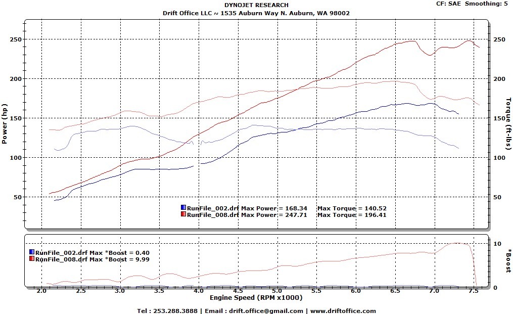

Here is my dyno sheet of NA untuned vs. vortech kit. I think Bob ordered his vortech today. :)
There is a weird drop at 6800, you can't feel it while driving. It's not specific to vortech, not only my car. It shows up on the hks supercharger also and several other cars. Jeff is currently working on it and Bob @ Drift office wants to find a fix also. The pesky torque dip WILL NOT go away on stock header, aftermarket header is a MUST on any build at all.

2forme 05-31-2013 09:11 PM
Why do all these dynos have bad dips up high??
Sportsguy83 05-31-2013 09:18 PM
Very nicely done @Wonderbar, so gratifying when you see your money an deffort into something and the results are awesome.
Wonderbar 05-31-2013 09:44 PM
We are working on it. Not *all of the cars have it. I think it has to do with the stock header. It may be the ecutek software itself being weird. We gotta work to figure it out.
charged86 05-31-2013 09:58 PM
I cannot feel my drop. and im not sure I have one im Visconti tuned tho
Wonderbar 06-01-2013 01:59 PM
Does it show on your dyno? I wouldn't have noticed mine if I didn't have the graph in front of me.
