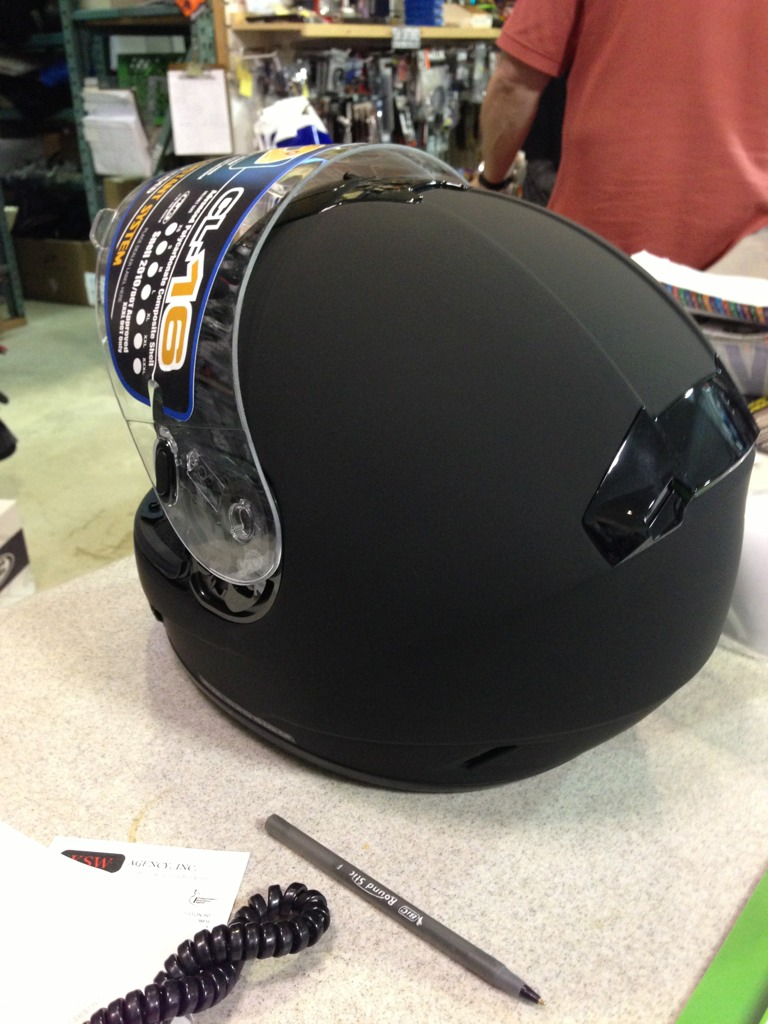

Lee358 05-31-2013 01:47 PM
I ended up with a hjc cl-16 Attachment 39166

Lee358 05-31-2013 03:47 PM
Originally Posted by fatoni (Post 972922)
i was just about to say that i think the best options for a racing helmet would be either the pyrotect airflow or the hjc ar-10 2.
im pretty sure what you bought is a motorcycle helmet so you may have trouble at some events but hjc makes really nice helmets.
Yes its only m2010 not se2010 so it is not fire rated but i should be alright with the events im doing
