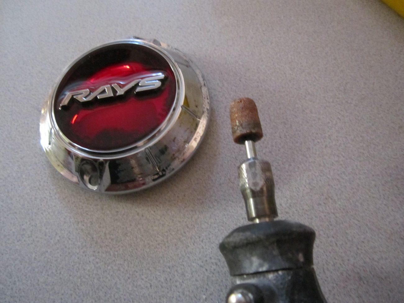

Scratch the chrome surface, it acelerate the etching(plastic chrome plating is made with multiple metal layer, one of them is copper(under the chrome), the acid love copper:wub:.

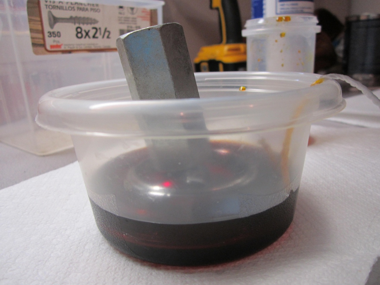

Next, dip it(time will depend on multiple factor, like temperature, plating thickness, ...) normally it would be faster if you vibrate the acid/part, but depending on the application it can not be possible, like this one, I wanted to keep the chrome on the "RAYS", so I haded to be careful not to have acid to the top of the part, so no shaking. For this part, it did take a few hour to completly eat the metal.
Attachment 38841
PS: One thing to be careful is that the chrome will dissolve in small parts, those parts can stick permanently to the red silicone on top of the part.

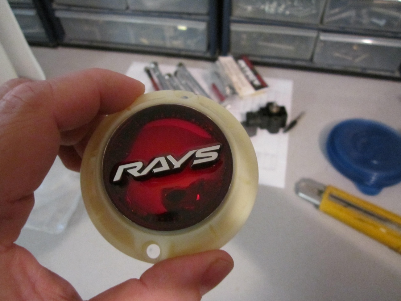

Attachment 38842
