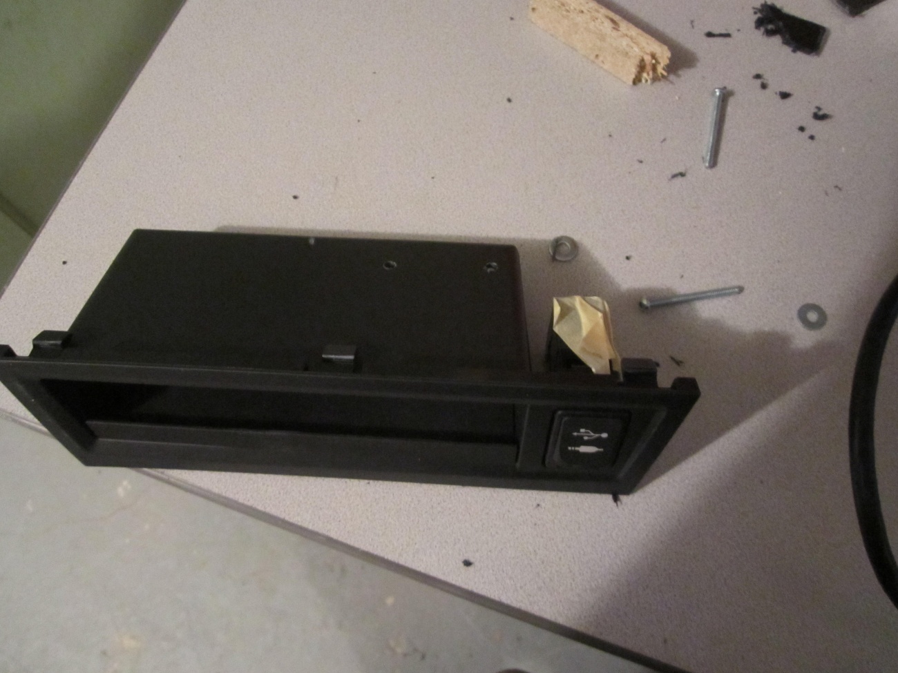

-Nowt his will help you to remove the filler where USB/hole(finally you will be able to put to good use that hole!;))

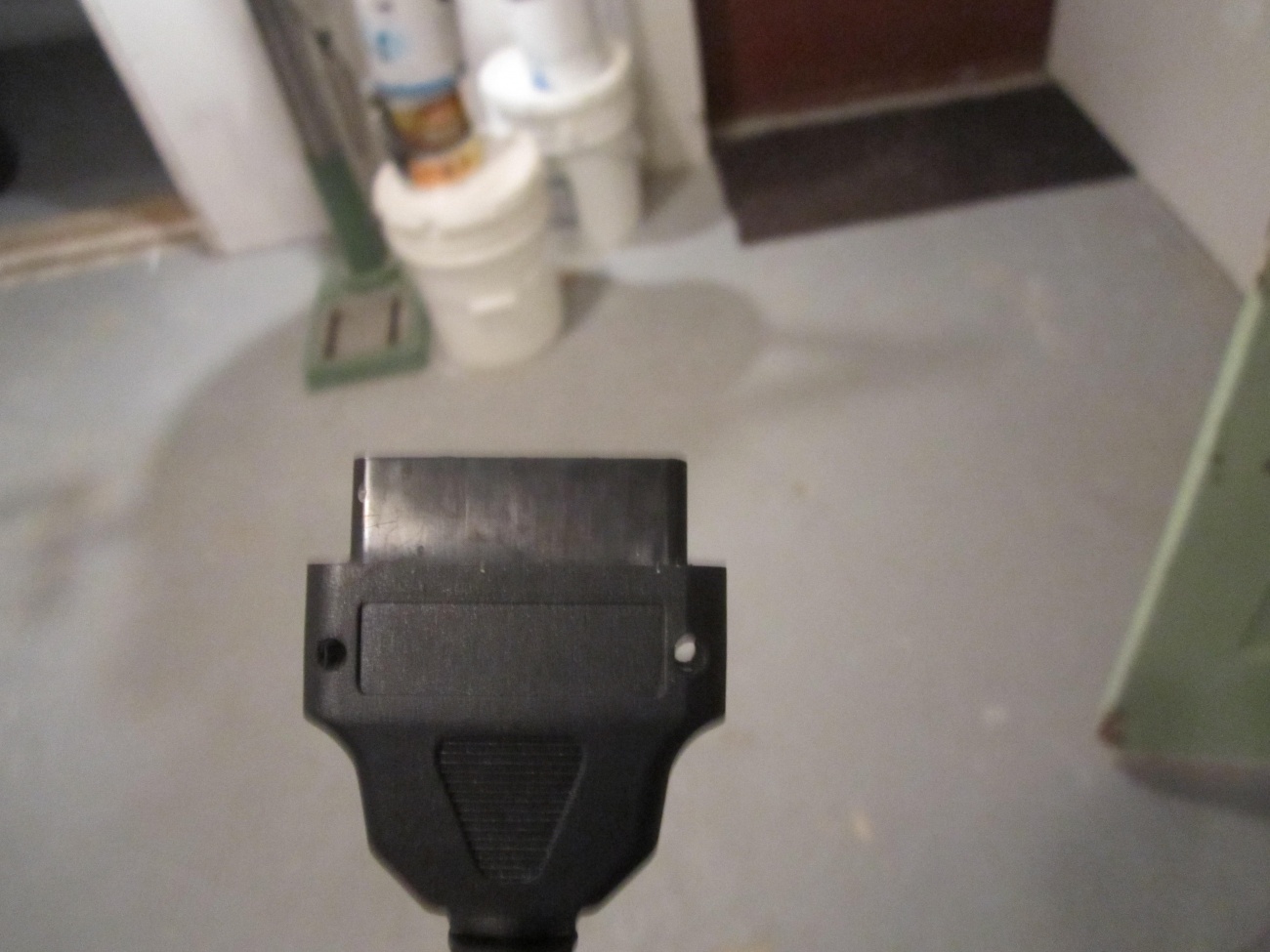

-Next drill 2 holes(6-32 screw size) in the side of the male connector(sorry for the shaky picture)
Attachment 38830
Use a dremmel to cut the square hole(size of the ODBII connector) on the back of the plastic part.

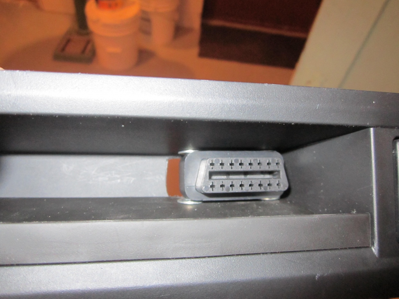

Drill 2 holes(using the holes on your OBDII connector as template) on the top of the plastic part, put your OBDII connector inside and drill through 1 of the hole on the bottom of the plastic part, put the screw in and drill the other one(that is to make sure the holes on the top and the bottom is correctly align with the OBDII holes).
Attachment 38834
Insert the connector, put the 2 screw in with the washers(1 on the top and 1 on the bottom/per screw in my case)
Attachment 38835

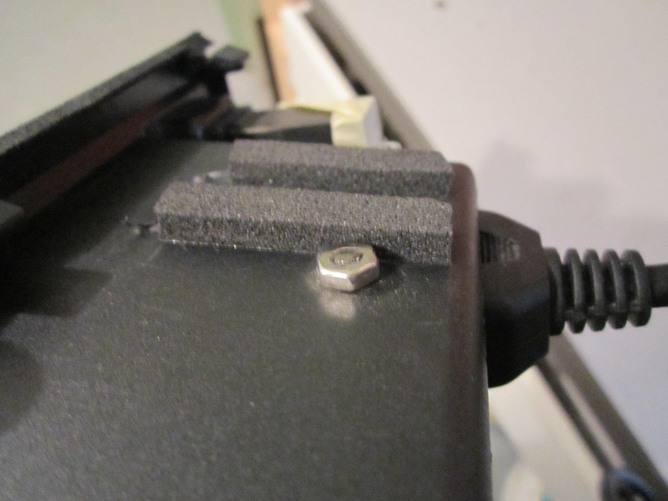

Put the nut(with locktite) and cut the screw flush to the nut(I use a dremel), you can put some self stickin window rubber just in case it vibrate and touch something(for sound)
Attachment 38836

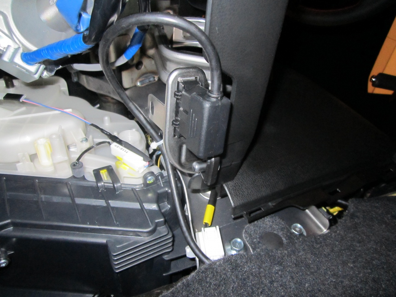

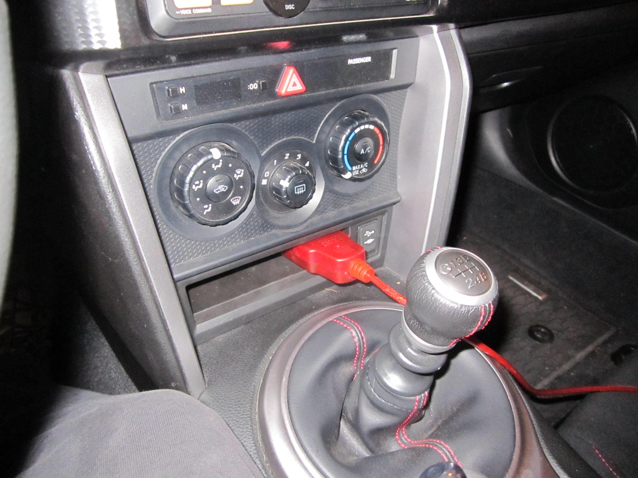

Reinstall in the car, should end up with something like that.
Attachment 38837
Attachment 38838
