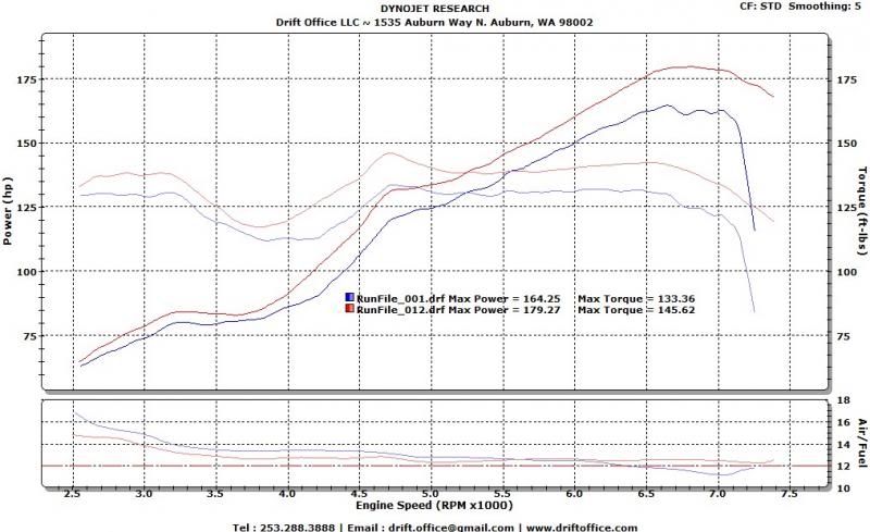

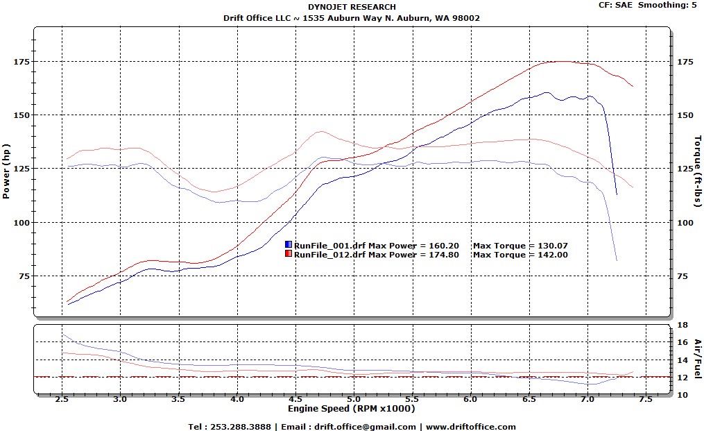

On to the tune: Outside of just looking at the numbers, I have to say the tune made a huge different - even more than I thought honestly (have to keep reminding myself: 2700 lbs, 2700 lbs...). I can pull out of corners much more quickly and smoothly now, everything feels more responsive about 4K, and the car seems more alive in the lower rpms (big chunk of the dip was cut out by the tune as you can see). It's just, overall, much more fun to drive. The increase definitely helps with passing at freeway speeds, the power doesn't die down as quickly. And it sounds much better too!
Overall, considering a lot of mods out there don't really do anything for a fair amount of $$$, this is great bang for the buck. Only issue is that I'm more tempted to drive, let's say, in a spirited fashion (although, I'm actually getting better MPGs I think.. need more time to average it out more)
Here's the 3rd gear pull (stock vs tuned):
Attachment 38021

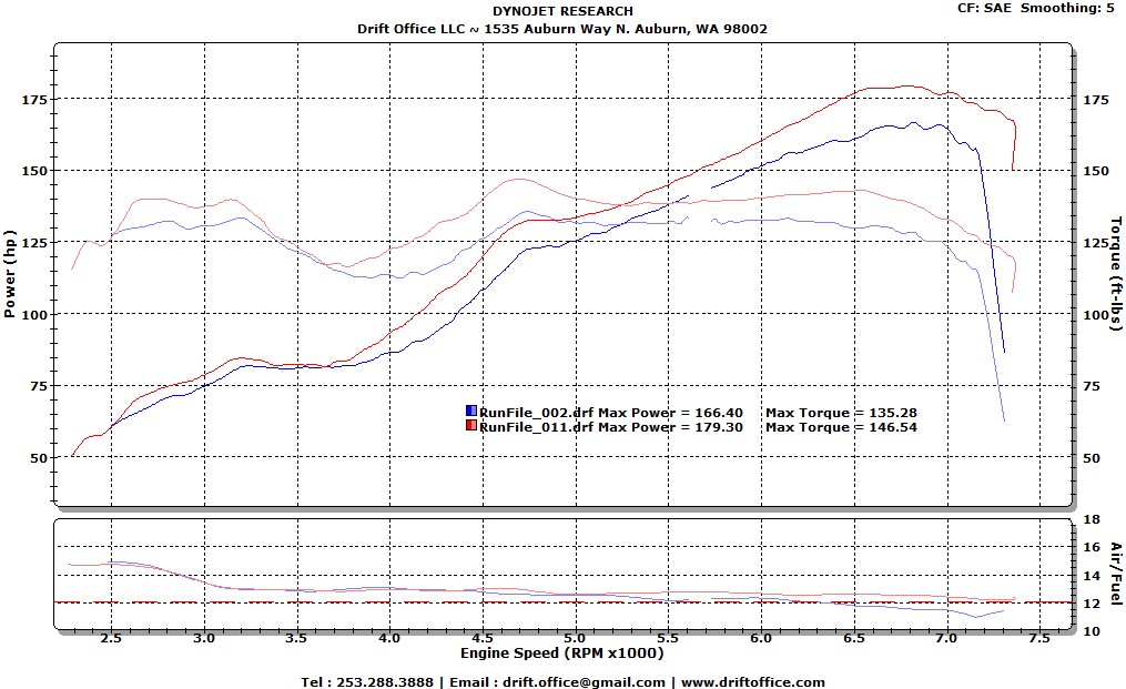

And the 4th (stock vs tuned):
Attachment 38022
Calum 05-20-2013 03:26 PM
nice gains!

I'll say this: If you look at, say, a Perrin intake at $310 and it gives a claimed 5hp, for less than that (but +EcuTek License cost, remember..) I got upwards to 20HP in some RPMs it's pretty much destroys any other mod for HP gains per dollar cost.
Lonewolf 05-20-2013 07:39 PM
Those are really nice numbers just from a tune...congrats:happy0180:
