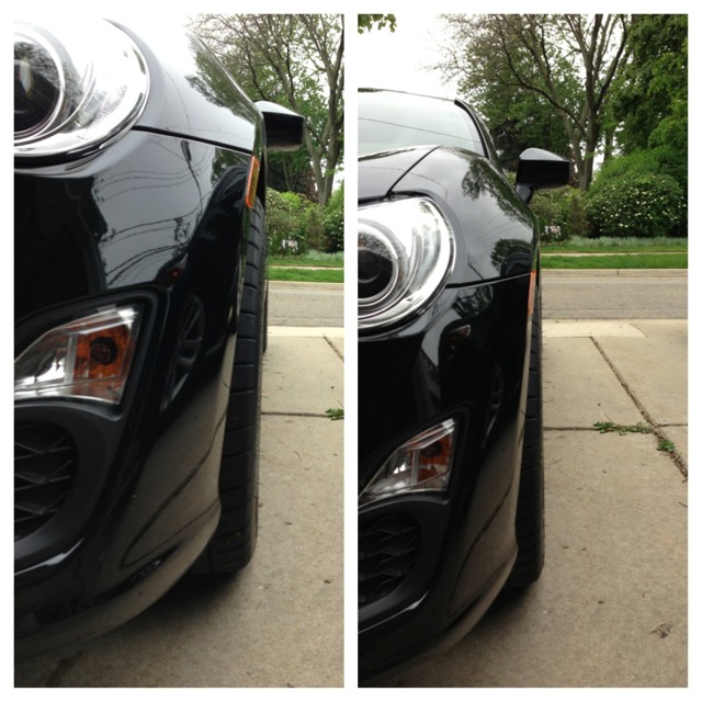

I just put the 901000394 camber bolts in the front. I figured some people would line to see the difference so heres a pic of before and after. Can anybody estimate the camber I have right now?Attachment 37536
No. . but I didn't stay at a Holiday Inn last night so maybe that's why.
You could get a rough estimate with a plumb line, a tape measure, and some trig. ;)

hapa_kcm 05-17-2013 10:50 AM
I can tell you after installing those bolts and a 1" drop I had -1.5°
troek 05-17-2013 10:57 AM
theres an app called clinometer if you have an iphone. its been accurate within .1 degree on me and my buddies cars after alignment.

normanb21 05-17-2013 11:35 AM
I was tryin to get more negative. I'm still on stock ride height

normanb21 05-17-2013 11:51 AM
Oh thanks, this app is awesome. I could probably figure out the toe too

mad_sb 05-17-2013 02:35 PM
I hope you plan on an alignment .. change to camber changes toe as well and you really need to set it up properly if you want it to handle correctly. camber is almost never the same side to side stock, so maxing out the lobe on the crash bolts will not result in the same camber on each side and as a result toe will not only change, but likely go wonky (more toe in or out one side than the other).

jeebus 05-17-2013 06:45 PM
you probably have around 1 degree. That's all I was able to get with crash bolts. Now that I have RCE yellows and crash bolts, I have 1.4
