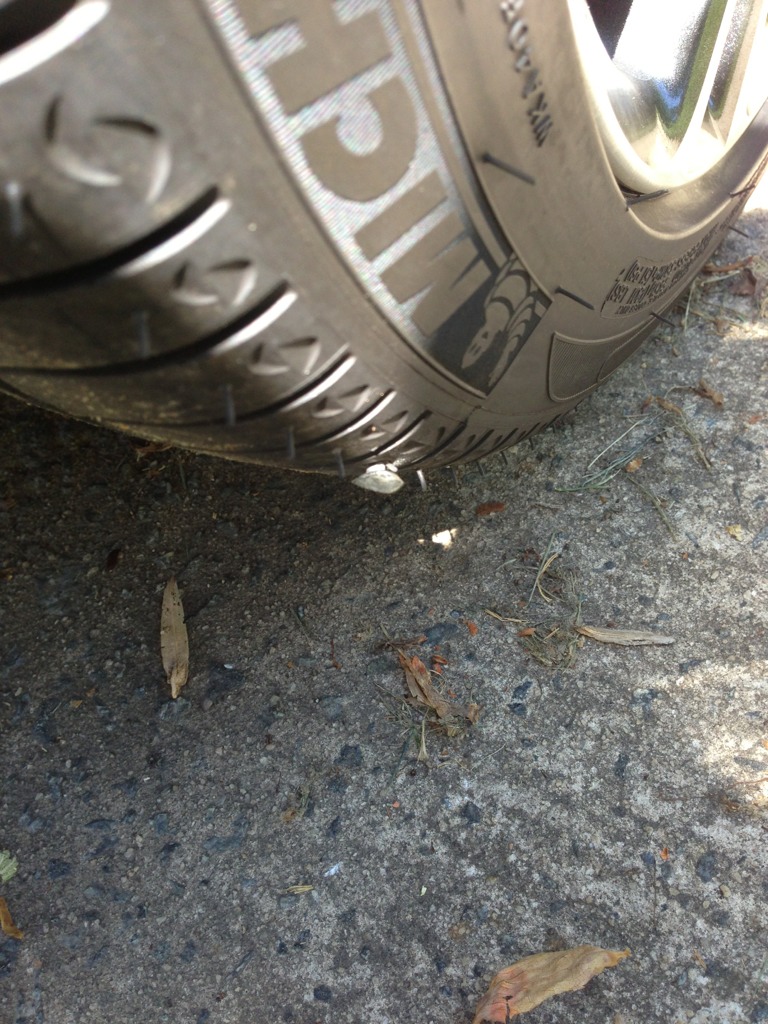

gr8scott 05-14-2013 03:19 PM
Not even three weeks
Already got small paint chip on front bumper and
Attachment 37278
Whitigir 05-14-2013 03:21 PM
Paint chips will buff Right off, with some touch up paint later.
Tires can be Patched right up !
Cheer :D
Fish 05-14-2013 03:24 PM
That sucks. I personally think thats too close to the sidewall for me to want to patch safely. I was trained 1" or less to sidewall and tire is done.
gr8scott 05-14-2013 03:26 PM
Haven't made a payment yet ha can't afford tire till car paid off!

immortal_suby 05-14-2013 05:03 PM
Too far into the shoulder to repair safely - tough luck on that nail.
