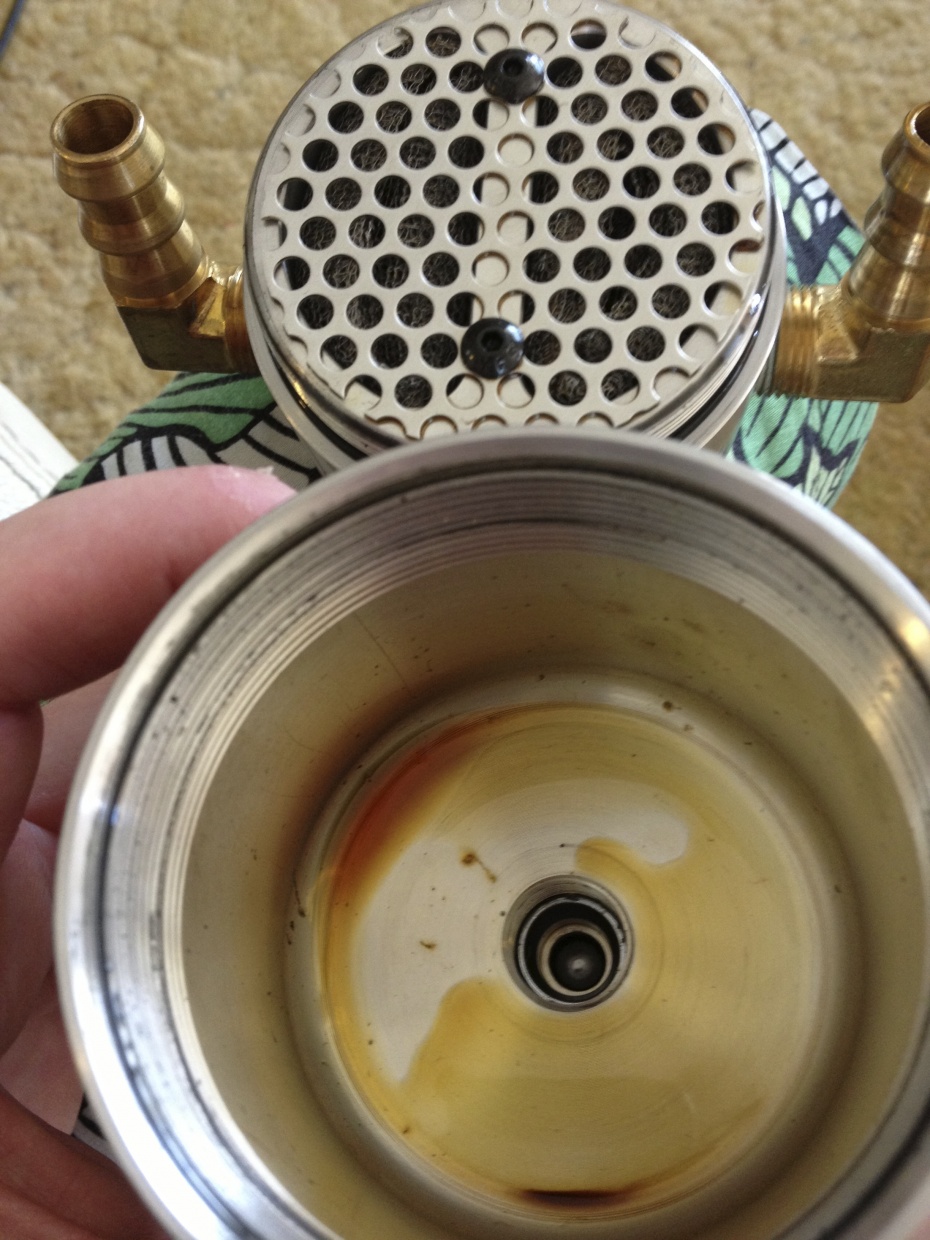

Moroso oil/air separator plumbed into the PCV.
Installed at approx 2,000-3,000km's, the car has just passed 6,000km's.
Only very occasionally winding the engine out on the street. One track day.
I only just opened it on the weekend and there is bugger all oil in it. I was worried it may have been passing through, but the outlet into the Plenum is completely dry. So seams to be working.
Below is a pic of the opened separator.

dokterdewe 05-01-2013 08:05 AM
what setup is yours ?

Walldodger 05-01-2013 08:47 PM
It's closed loop, plumbed inline with the PCV. The line on top of the plastic intake plenum. Not the breather hose.
Below is what I'm using. The type with the tap on the bottom.
http://www.moroso.com/catalog/catego...?catcode=18549
