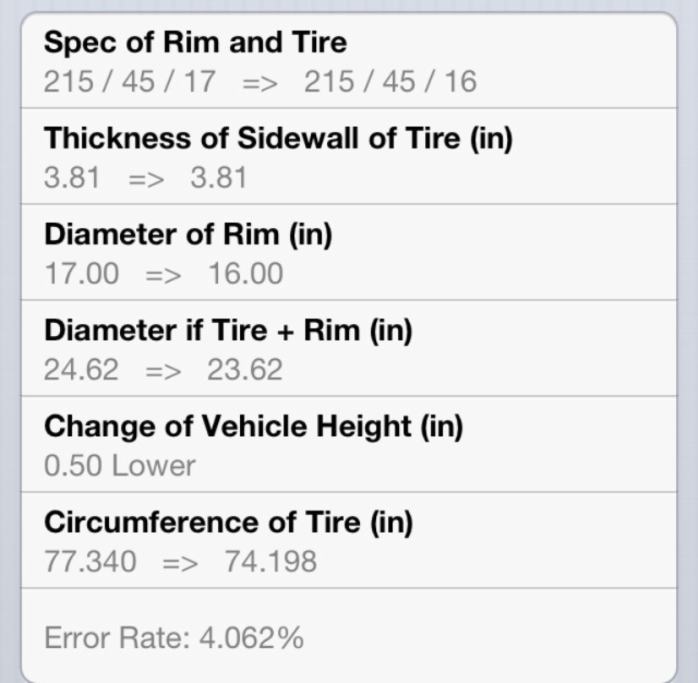

jshadeck 04-03-2013 03:48 PM
Let me put this in simpler/frs lingo...
Lets say i have stock 215/45/17 , what happens if i put a 215/45/16 on the fronts?
norsamerican 04-03-2013 03:49 PM
The front end will be closer to the ground. Slightly less traction, slightly lower profile tire.

jshadeck 04-03-2013 04:05 PM
http://mcgrefer.com/sizeinfo/width-2...page-1-profile
Link doesnt seem to open for me.
Agreed, in this scenario the nose will be .5" lower.
Less traction? Its still a 215 wide... Could you explain? Unless u mean the contact patch from front to back is smaller as the circumference is 4% smaller.. But thats so small it wont be noticed.
Lower profile? A 215/45 is = 215/45 exactly
jshadeck 04-03-2013 04:07 PM
Attachment 32727
