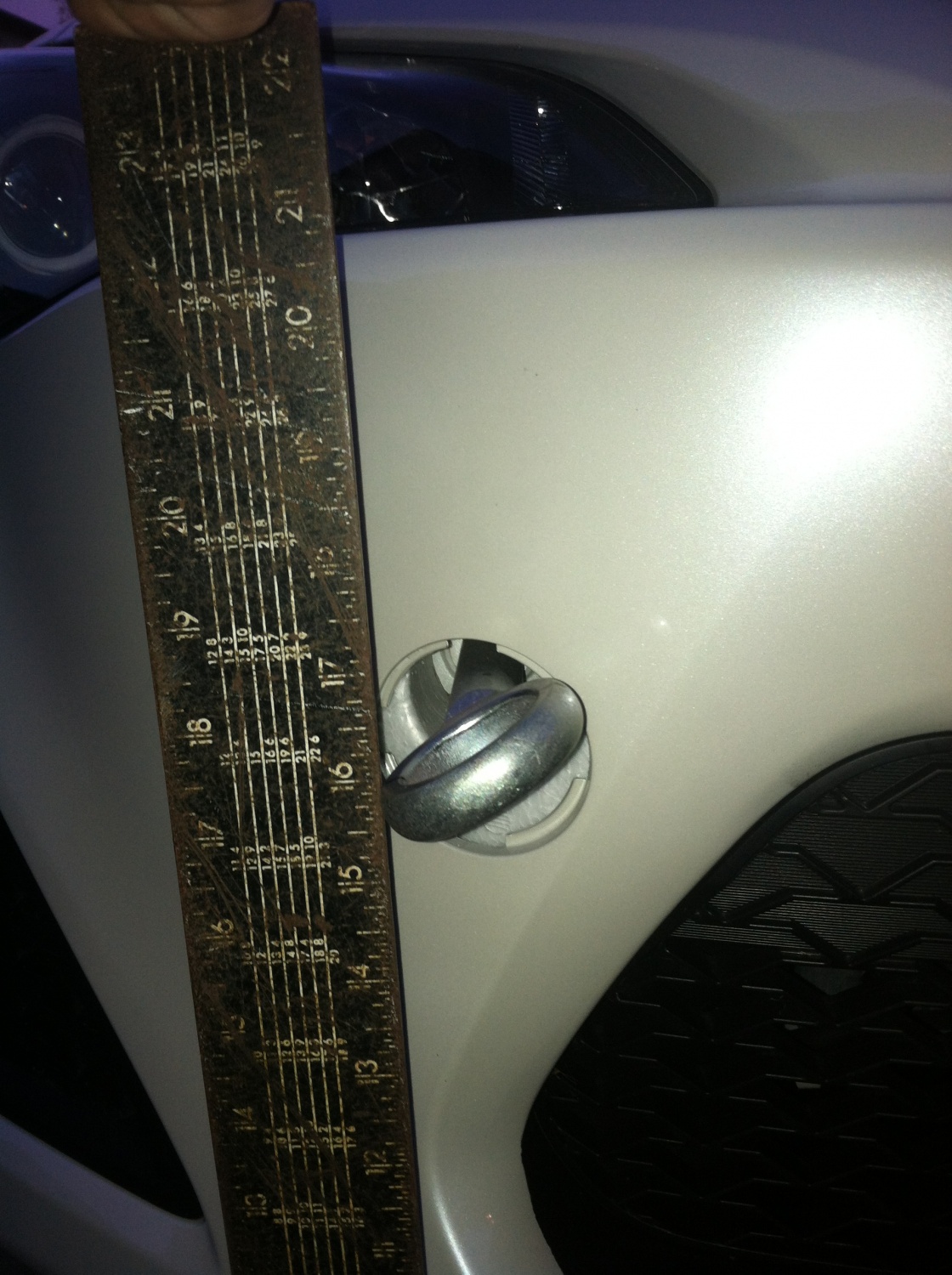

Step 1: Grab your tow hook, screw it in and tighten it as much as you can. You want to mark where you need to cut it (keep in mind the bracket sticks out, if you want it centered like mine, you need to account for the room it will take up to make sure it doesn't hit your bumper.)

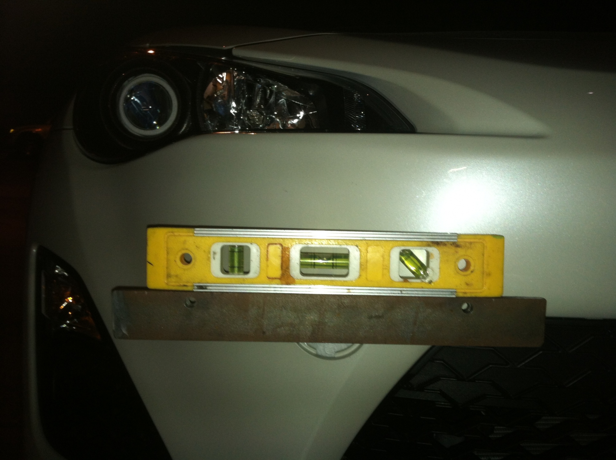

Step 6: Re-insert the tow hook to the factory hole. Using a level (and make sure you're on level ground in all directions) position the back plate where you want it to sit. Once you're happy with the position and sure it's level, mark the back with a sharpie where it needs to be welded.

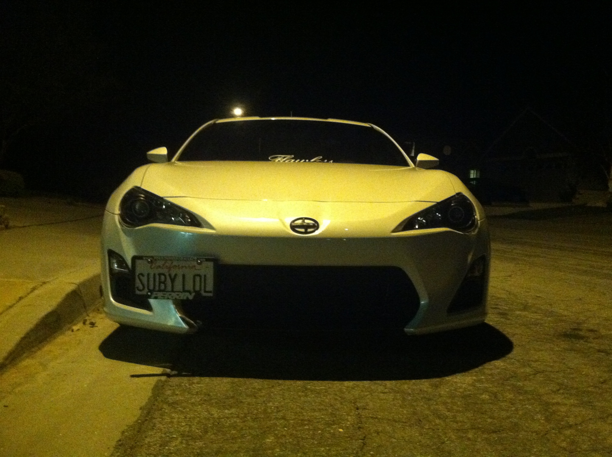

Step 8: Remove it again, finish off the welds, and make sure they're strong. Once you're good to go, cool it off in some water. Grind it down a bit with a sanding blade to make it nice and smooth. After that, a coat of primer, a coat of black paint, and you're good to go!

TrueLoneReaper 02-05-2015 12:44 PM
Nice! Have you noticed if the plate itself flexes at speed? My brother has a similar setup on his car and the plate tends to rub against the bumper with the wind.
