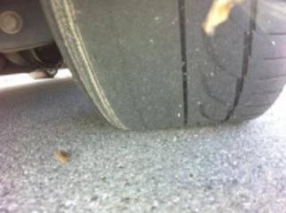

jshadeck 03-24-2013 11:38 AM
2 Attachment(s)
Too much camber can cause tremendous loss of traction, both for acceleration and braking, to the less than average driver, these cars are proving "dangerous" w the nannies turned off... Imagine that same situation, but with 1/3 less of each tread touching the pavement.
I agree camber doesnt cause wear nessecarily, alot of people associate the two because when cambered, the lack of traction often wears the tires down faster.
Attachment 31714
My is300 had a little bit of camber and no traction control, i drove on very shot tires alot too
This is how my tire looked when i pulled over to the side of the road from 90mph when i saw my (front) tire fly off the rim and continue down the highway
Attachment 31715
The rims "life" was saved by half an inch of sidewall that stayed on the rim :/

jshadeck 03-24-2013 12:29 PM
I dont like the look for my own cars either, the is300 was dialed out as far as possible w out a camber kit, and if id adjusted it much more the sidewall would have rubbed the fender
