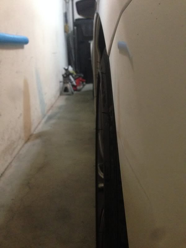

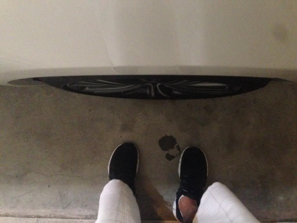

suaveflooder 10-21-2013 01:05 AM
Originally Posted by DAEMANO (Post 1282433)
**Point of clarity - When discussing "flushness" generally (on this board) it refers to being on the same plane with the top of the fender. I think @suaveflooder is talking about being flush with another part of the fender (the side or bottom perhaps), which is totally ok too. Just don't be confused at the varying recommendations due to this variable.
With that being said 20mm front and 25mm rear fits very well. There are probably a dozen examples on the board now with that combination (including my own car (posted earlier)). For perfect flush (with the top of the fender) 20mm front and 30mm rear is flush as an ironing board.
Keep in mind thick spacers like these weigh over 1lb each so you will be adding unsprung weight to each corner.
Phone is sitting ON the car. I'm talking about the part where the tire meets up with the rim. Before the bulge of the tire stuck out PAST the fender. Took a look at some cars that I liked the stance. Porsche mostly, because it had a big ass like our cars (I work in a fine dining restaurant, so this was not hard to come by) and made my decision based on that. The idea is to make the car look "stock" while filling out some of it's obvious flaws (my opinion on the "flaws") the rim itself is right on the fender, top of the tire, slightly in, part where the tire meets up with the rim, on the fender.
I think that people associate the top of the tire with the fender as being "flush" which is what a 25mm spacer does. Sadly, there is a touch of "stretch" on the stock rims with the stock tires, leaving a bulge sticking out past the rims. It simply wasn't working for me. This looks GREAT on muscle cars where the tire is wider than the rim, but when the sidewall sits out further than the tread of the tire, it looks like it has a spacer IMHO (might change with different tires or more camber as MPI_Jack mentioned).
Sorry to argue on this. I literally have the car sitting right in front of me. I can take pics of what ever you want. You can see in my pics on post above.
(Sorry, just took these pics. Car is dirty, and I haven't driven it in a couple days)
http://i62.photobucket.com/albums/h8...psc2de85a6.jpg
http://i62.photobucket.com/albums/h8...ps68237ea0.jpg
http://i62.photobucket.com/albums/h8...ps076b184e.jpg

suaveflooder 10-21-2013 02:56 AM
Wheel Spacer Size??
Originally Posted by DAEMANO (Post 1282600)
@suaveflooder Not that I'm trying to get into some internet debate about it, but I also have tons of pics with 25mm in the rear & 20mm in the front and it does not poke at all. The wheels (and tires) are flush with the top of the fender. Same with a lot of other people on the board. Don't know why yours were poking at these sizes, nobody else I've seen has reported that. The stock tires do have "sidewall protection" (an extra layer of rubber on the sidewall that makes them look stretched when they're not), but even that really doesn't seem to poke at these sizes.
http://www.ft86club.com/forums/showp...3&postcount=72
http://www.ft86club.com/forums/showthread.php?t=22596
http://www.ft86club.com/forums/showthread.php?t=42516
http://www.ft86club.com/forums/showthread.php?t=27873
And my FRS with 20mm and 25mm
REAR - Raven FRS 25mm spacer vs stock WRB BRZ
As you can see the rear 25mm on the Raven FRS has another 5 - 10mm of gap still available to be filled if someone wanted to go 30mm.
http://i.imgur.com/jYABNlS.jpg
Another pic same car
25mm Rear - 20mm Front - Neither is poking whatsoever beyond the top of the fender.
http://i.imgur.com/5s5BLq3.jpg
http://i.imgur.com/dVoJDLy.jpg
I'm seeing what I saw on mine :/. I assume it's just a difference in preference. I'm not really trying to start an argument either. I'm guessing our ideas of "flush" are different. I have pics with all the spacers on and it looks just like the ones you posted. I wasn't happy :(
If you look at the pics closely, the TOP of the tire is very close to even with the fender. It's not easy to see in pictures, but in person, the tire would be past the fender. That's what I didn't my like on mine
