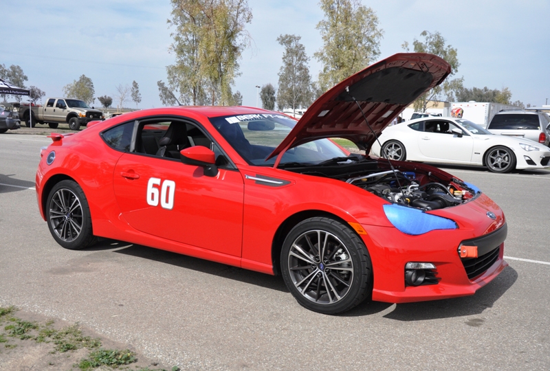

Howdy folks! Just thought I'd post up some pics of my BRZ in development. It's a daily driver but I also track the car from time to time as well. If you guys have any suggestions on any parts that would compliment what I'm putting on the car, I'd love to hear it!

Here's my car at the moment (will update over time):
http://i.imgur.com/HJNFZG4.png
http://i.imgur.com/Z4CE4F4.png
http://i.imgur.com/DDr3c4b.png

With the Greddy T518Z Turbo kit, the car is making more than 50% more power with a decently smooth spool up coming in at about 3.5k RPMs. The BOV is recirculated to keep the set up as efficient as we can. Nearly all the piping has been coated and wrapped and the car has been conservatively tuned for hard track use. With nearly 20k miles and 20+ track days with the turbo, the car is holding up pretty well. Cooling solutions include the Robispec V2 Radiator/Oil Cooler combo as well as upgraded Spal fans with a shroud by @Carolina Dyno.
http://i.imgur.com/CDyN7vX.png
http://i.imgur.com/C3efQAx.jpg
http://i.imgur.com/1uLXXDn.png
