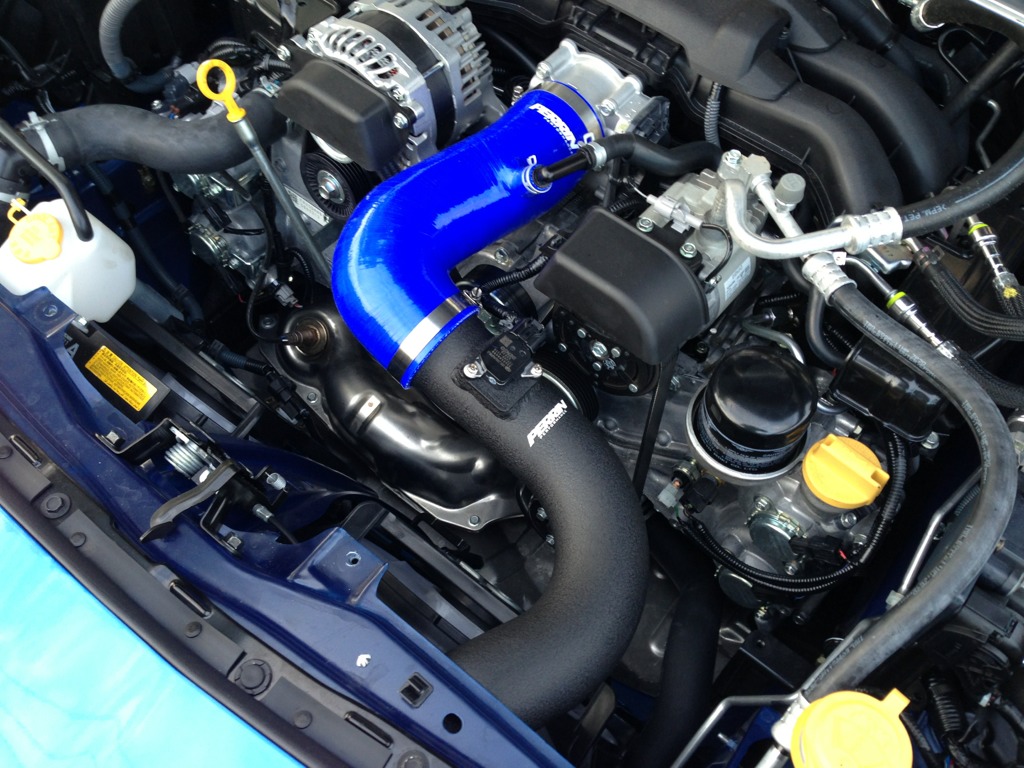

chadstyle 01-31-2013 05:34 PM
2 Attachment(s)
Here's a couple pics I took with my phone..Attachment 26965Attachment 26966
