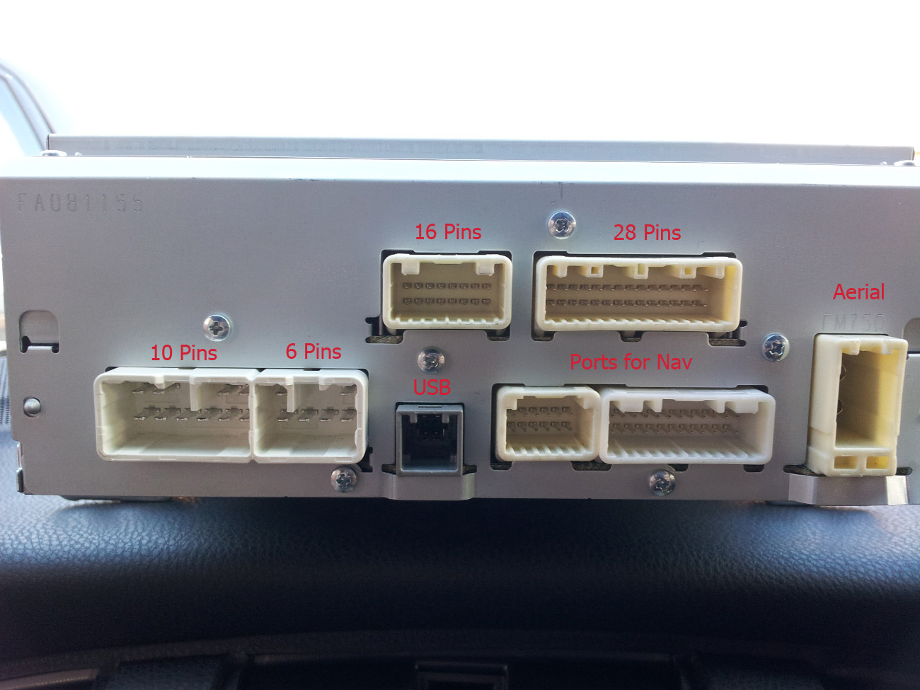

This is an image of the back of the headunit which is the same as mine (image is by member keethos) -
Attachment 26096
I had my headunit out and was wondering what the 28pins and 16pins connections are for. I disconnected these and tried the headunit without them connected and everything still worked as far as I could tell. Didn't test the aux input as had nothing to test it with. Is this what these 2 connections are for?

The 28 and 16 pin ones weren't even connected on my car, but all the cabling and plugs where attached to the loom. My car had Bluetooth (no external mic) and USB/AUX built into the headunit, so that might be a possibility.

The 28 pin connector is for AUX, steering switches (not installed on GT86), microphone, speed signel, reverse signal (for back camera) and the ignition signal.
The 16 pin connector is for the backcamera connection.
