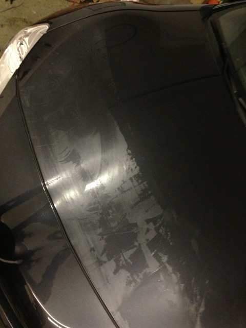

Ok guys I need some serious help. My car is at the shop getting detailed and opticoated. I had the guy take off my clear bra that came with the car on my hood. The problem is that a lot of the adhesive still remains and he said that he's tried goo off and things like that and nothings working. Its a 3M bra, any suggestions? Hes going to spend all day tomorrow with it.

I would try heat. My clear bra guy is not in the shop today otherwise I would ask him.

He said that he has tried goo off, a heat gun, WD-40 and i think one or two other things. He said he didnt want to mess up the paint with the WD-40 though so he didnt want to use to much or let it sit too long or anything.
cnk 01-05-2013 03:07 PM
3M adhesive and tar remover usually works well for me.

Duplicolor makes a product called "Duplicolor paint prep spray" Its a clear spray and clearcoat safe. I used it to remove the bra adhesive from my old 350z bumper. I sprayed small 1-2 ft sections then gently wipe off the adhesive. I bought a bag of cheap microfiber towels as they will get tacky quick. Good luck man!

Stoners Tarminator Clear coat safe, and is great at removing adhesive like this.
