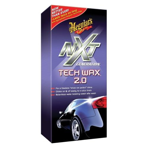

If you want you can try this. It's amazing and usually does the job.
Any auto store should have it. It comes with an applicator pad and I use a soft polishing/microfiber cloth to wipe off the wax.
http://ecx.images-amazon.com/images/...XL._SS500_.jpg
That is just a paint sealant ( no abrasives in it ) and unfortunately will do nothing to remove or even hide the swirls / holograms inflicted by the body shop.
