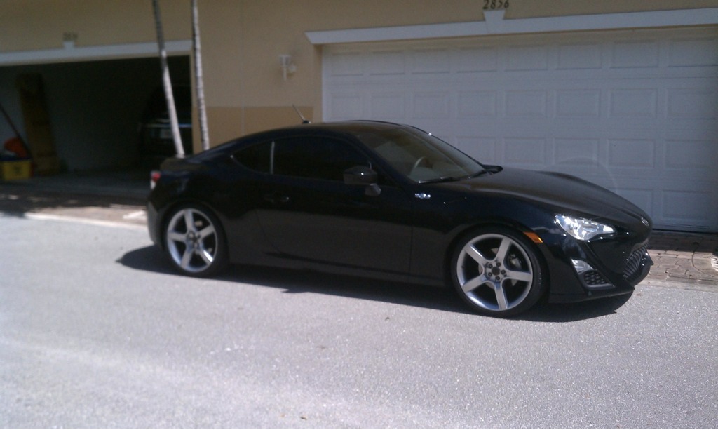

hayleybeaners 12-26-2012 09:04 AM
Attachment 23625
Sportlines for 4000 miles with no issues.
