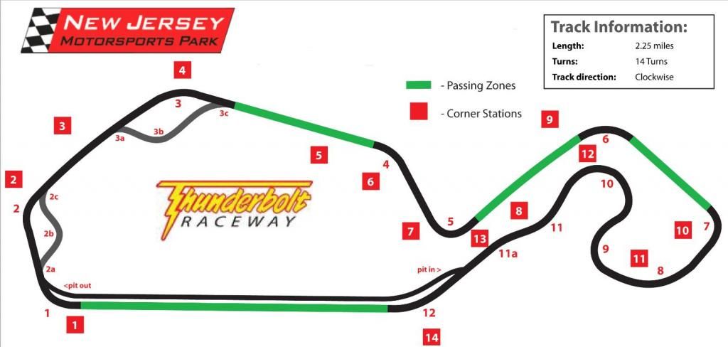

Watch this pro's video starting with the last two laps at 25:27, and notice where he places the car when other cars are not interfering with his line: [ame="https://www.youtube.com/watch?v=yCdR8xD6B8w"]https://www.youtube.com/watch?v=yCdR8xD6B8w[/ame].
That's the line around that race track. IIRC, he hits the T1 apex curb on one lap, and it upsets the car to no useful purpose. That curb is to be avoided unless you're in a race and you need it while defending.
Notice especially that he doesn't track all the way out after T4 apex, nor track all the way right prior to T5 turn-in; this is so that he's set up to use as much curb as possible in T5, enabling him to come out of T5 harder because he's placing his right-side tires down where the most camber is available.
Also, notice his braking prior to turn-in to T9. At 26:28 and again at 27:57, he's all the way to the right at the curb that's between T8 and T9, and then he straightens out so that he's straight-line braking. This allows him to carry his speed further, brake in a straight line, which gives him better control and asks much less of his left front tire (because he's not braking and turning right at the same time), and makes it much easier to make any minor adjustments at turn-in. It also makes it easier to move the car towards the right-side T9 apex curbing prior to moving over to the T10 curbing at its beginning.
The reason to get way down on the curb in T10 is the same as it is in T5: that's where the camber is for your loaded tires; in both cases, you put your unloaded tires way up on the curbing (or even further inside on the dirt if you want), and that will enable the loaded tires to use the most camber the turn has to offer. It's also what will make you fastest going through and coming out of those corners. You do the same thing in T2 - not for the camber (there isn't any), but because it's the fastest route between T1 and T2 track-outs. Anywhere on that track that you see red dirt on the inside of the apex curbing is where the fast drivers are placing their inside tires.
This short clip by the same driver explains the rationale for the straight-line braking sequence prior to T9:
[ame="https://www.youtube.com/watch?v=ANGCVV9ZxTs"]https://www.youtube.com/watch?v=ANGCVV9ZxTs[/ame]
This one will explain why you're using as much T1 track-out curbing as possible:
[ame="https://www.youtube.com/watch?v=lgIM6r7NpqE"]https://www.youtube.com/watch?v=lgIM6r7NpqE[/ame]
Notice how much more curb he's using in some spots; for example, the T2 apex and track-out, and the T12 track-out onto the main straight.
The turn numbers are the ones on this map which are not enclosed by red squares:
http://i253.photobucket.com/albums/h...4.jpg~original

Yes, I have yet to figure out T9 and T10. Could probably shave off another 2-3 seconds by doing it the right way and setting it properly for T11-12 and the main straight.
