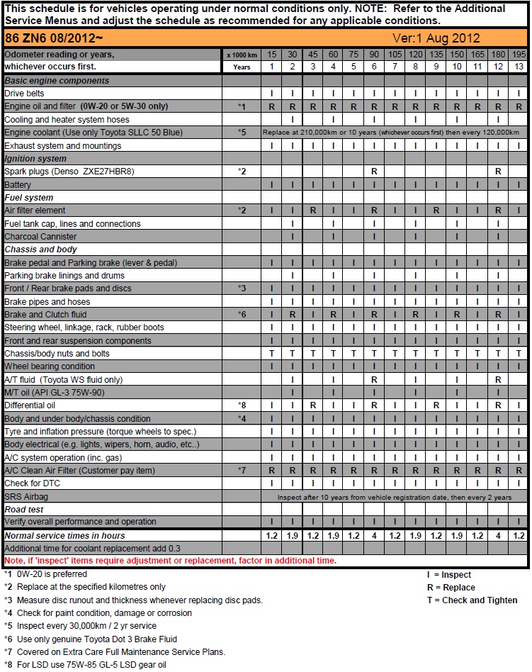

st162celica 12-04-2012 11:49 PM
Originally Posted by Captain Snooze (Post 589026)
I have just phoned the Subaru dealership service department try to find out what actually gets done during each of the services. I was referred to the Subaru Australia website; it lists the service plans but doesn't actually say what is supposed to be done. In the course of conversation it was mentioned that the late model vehicles with timing chains don't need to have them replaced unlike timing belts. Do chains that are constantly running in oil never wear out? (When I say never I mean within the life of the engine). Does anyone have an opinion on this?
I found this a while ago and saved it. Couldn't find the link on FT86club
Attachment 21768
