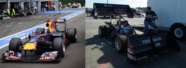

old greg 11-12-2011 05:46 PM
Originally Posted by serialk11r (Post 74865)
The wings have crazy AoAs and are huge
Nah, they're adorable little things.
Attachment 2623
I give you A-mod. 240hp and a drag limited top speed of ~70 mph
