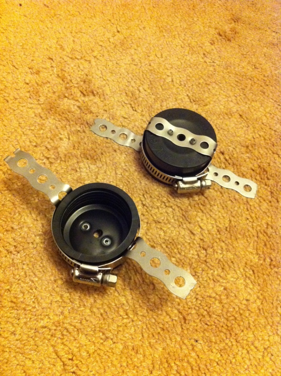

After hearing the initial harshness (even with the crossover tweet jumper set as low as it would go, and the deck treble turned down -2 or 3), I came up with these things (a couple of 1.25" rubber caps, pipe strap, & rivets) I then lined the tweets with a little weatherstrip tape to snug them into my new 'ghetto-holders'. I vaguely remembering counting off 11 large holes on the pipe strap, but would go 12 or 13 if I did it again, for adjustability sake:
Attachment 20322

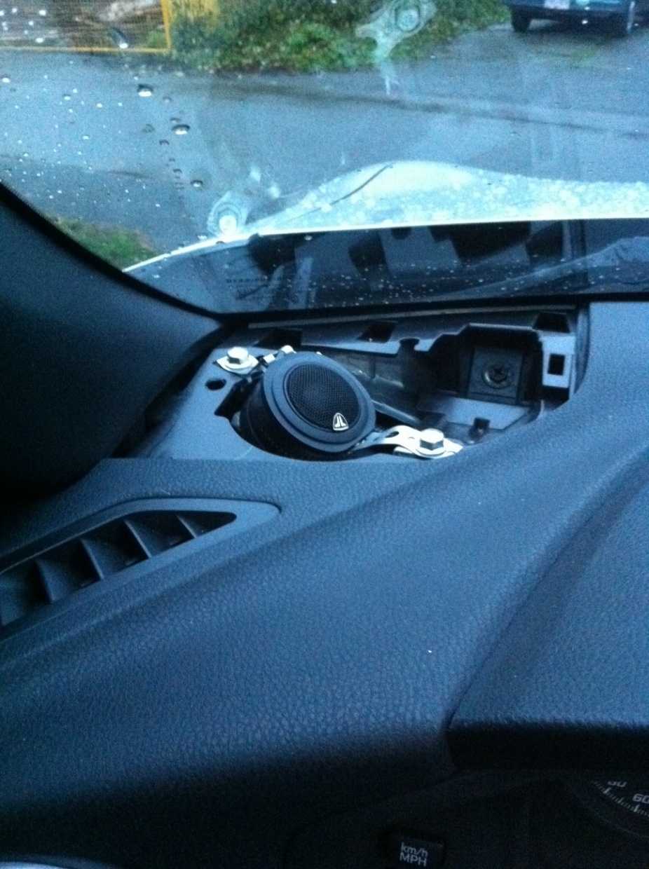

I then installed them and pointed each tweet at a spot just below the top opposite corner of the windshield:
Attachment 20323
It still seemed a hair harsh, but much better. I left the settings the way they were, and now suspect that the stock deck might be a little 'treble-biased'.
