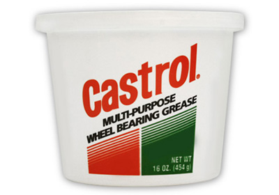

Stopped in at PartSource (Canada's pepboys) and ran into an old friend. Asked him about what to do and he basically said, oil's and sprays are yearly fixes because they'll drip/wash off eventually. What I wanted was some Multipurpose car grease.
Picked this up for 5 dollars.
Attachment 20248
I tossed on some latex gloves popped the wheels off and basically crammed grease into any moving joint I could find. It wasn't pretty, but after driving it for a few days and letting it "work" it's way into all the joints I can safely say no more squeaks! :party0030:
This little civic winterbeater is ready for the daily commutes again.
TL;DR - greased everything! no more squeaks.
Total Time: 2 hours
Heads up: if you're gonna do this, pay extra attention and make sure you do not get grease on your rotors or brake pads...( I know better, but some of you may not)

ok, no seriously, keep spray lube on the shelf where it belongs, not on your chassis..
I use http://www.lucasoil.com/products/dis...id=46&loc=show
its not pricey, you can get it on amazon, and its gonna last longer than the dino castrol above since its a synthetic, and was made for chassis type applications
