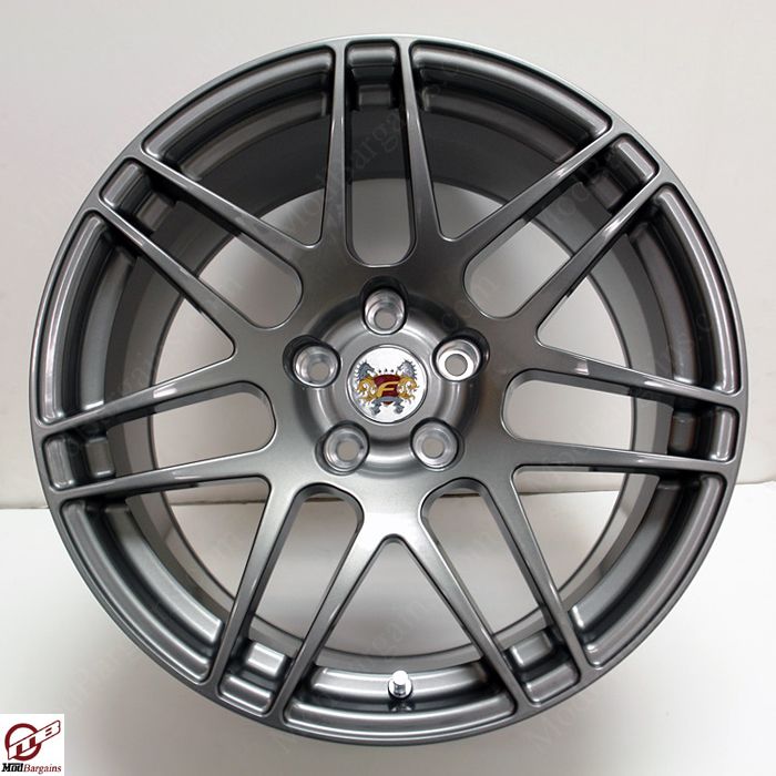

Tansey86 10-17-2012 12:27 AM
I agree with the work emotions, they are common, but for a reason.
http://f10.5post.com/forums/attachme...7&d=1292623008
Those are the forgestars, my favorite wheel personally.
Honestly, if you plan on going big power, I would advise something along the 18x9 front, 18x10.5 rear area. Its not so much about how wide the tire is, its about the quality of the tire. Most slicks you see run are no wider than 275. You have to find the perfect balance between width and stickyness.
I do like those honestly, but i was considering the Nurburgring ones because they are suppose to be really light and really strong due to the "Rotary Forging" process.

Forgestars are 3 piece forged wheels, much lighter than the Nurburgrings
18×8.5 +48 17.6 lbs or in metric 7.98kg
18×9.5 +48 19.4 lbs or in metric 8.80kg
18×10 +42 19.2 lbs or in metric 8.70kg
18×12 +68 20.0 lbs or in metric 9.07kg
^ forgestar f14 weights.

JoeBoxer 10-17-2012 12:57 AM
Forgestar for sure over TSW. Pick the exact offset you want down to the millimeter and more exotic finishes available as well. The gloss gunmetal for one looks really nice. I would also suggest looking at the SSR Professor MS3.
18x10.5 +22 with 255/35 and 265/35 tires on this Rocket Bunny car.
Also Crawford is now running 9.5 +38 with 285/30R18's in the rear if you are just getting the kit to get bigger tires you may not need it.
http://cdn.speedhunters.com/wp-conte...0/AY0F3277.jpg
Tansey86 10-17-2012 01:00 AM
Forgestar will actually set the offset to be perfect when you tell them what car its going on, keep in mind they do take a while to be delivered as every set is made to order.
