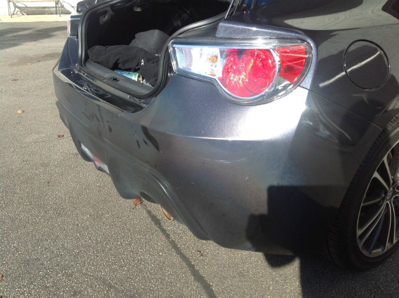

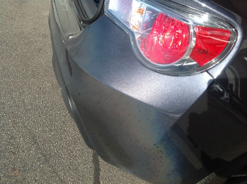

@Art_Mighty 10-08-2012 11:00 PM
Originally Posted by Xanatos (Post 484832)
Drain some out so you dont have to find out :happy0180:
Let's just say there's a reason im asking... :(
http://i1209.photobucket.com/albums/...mento/Oil2.jpg
http://i1209.photobucket.com/albums/...mento/Oil1.jpg
I actually havent seen the back of my car in sunlight until this morning. I picked her up from the dealer on Sat afternoon when she was squeeky clean and overfilled.
JoeBoxer 10-08-2012 11:04 PM
Wow that's awful, i would have them come pick it up on a flatbed tow truck and fix it.
usptwins 10-08-2012 11:09 PM
Id definately call them and say, "hey, my car is covered in oil, yall need to fix this because it wasn't like this when i brought it in." Or something to that effect lol. That just looks horrible. Whats it look like underneath the car??
Xanatos 10-08-2012 11:10 PM
Yeah you may have overflow oil in your cylinders. I see the bumper is spotty is that oily substance?
@Art_Mighty 10-08-2012 11:14 PM
So here's the funny part. I drove it over to the dealer and they said that the oil levels were fine even tho they were well above the top dot on the dip stick. Then I drove the car to a Subaru Dealer and a mechanic there said the same thing.

@Art_Mighty 10-08-2012 11:16 PM
We put it on a lift in the morning and it was as clean as a whistle.
@Art_Mighty 10-08-2012 11:19 PM
It's more dusty then anything. A huge portion of Lake Shore Drive (10miles) has been recently repaved with asphalt and I drive on it twice a day at least. Is it that and I'm overacting?
