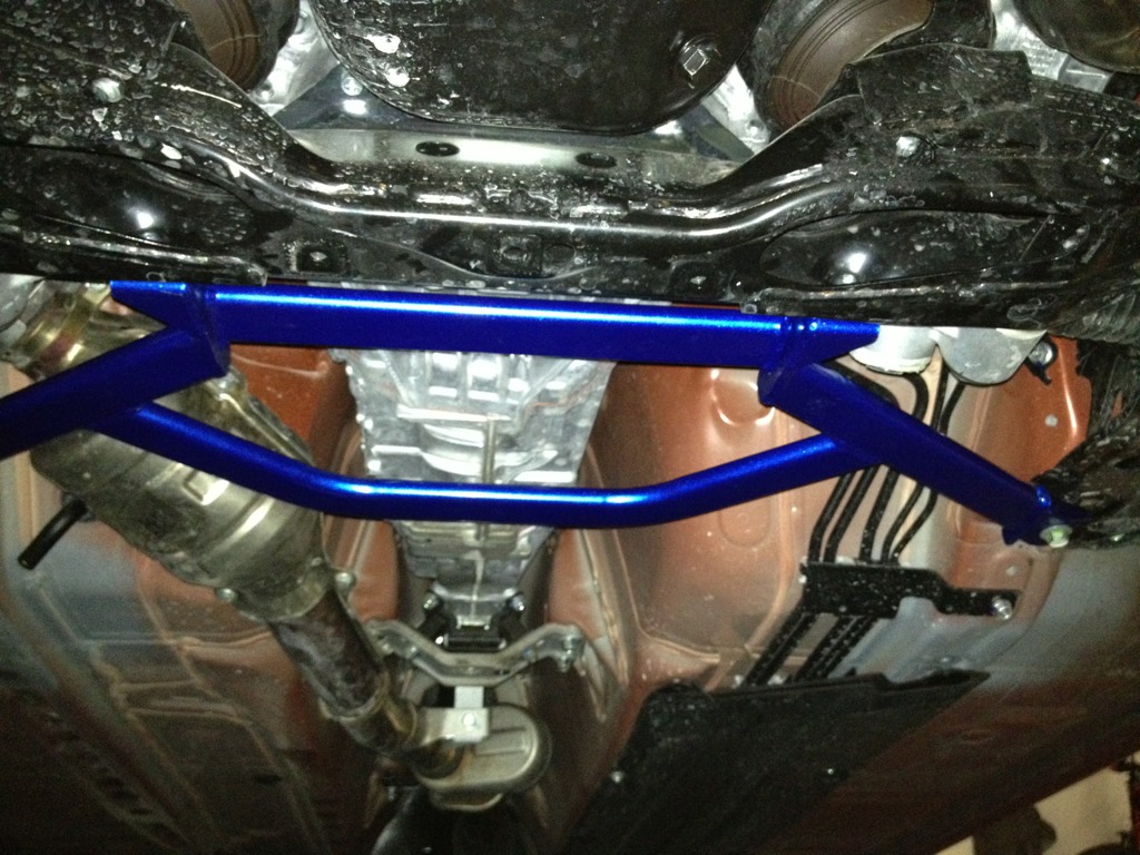

So I started my day yesterday with the intentions of getting my windows tinted and oil changed/car serviced. Got the tint done, very happy with the results, and made my way to the dealership. Long story short, while the car was being serviced I ended up buying several Cusco parts and made plans to buy the rest at a later date. This is to serve as a write up based on my personal experience with the parts so far. Enjoy.

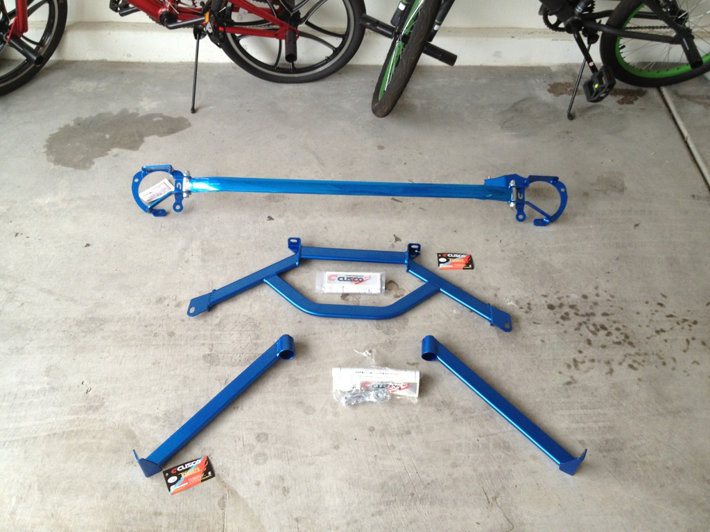

Parts

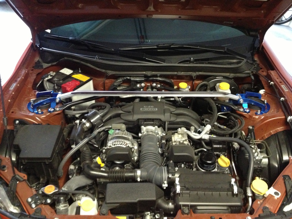

CUSCO Front OS Type Strut Bar w/Master Brake Cylinder Stop
CUSCO Rear Side Crossmember Powerbace
CUSCO Front Crossmember Powerbace
By far the easiest piece to put on the car. Just simply remove the strut tower bolts, back out the brake stop bolt to make room for install, loosen the adjustment on the strut bar, drop on the aligned holes, tighten each one snug, check fitment and then tighten all the way down.
These two pieces were pretty easy to install as well. You can figure out the mounting points from the pictures.
For this piece you will have to remove the skid plate and plastice piece underbody panel in order to install it. Both pieces fit perfectly back over it. Be sure to take pics of it before buttoning everything up.
Driving Impressions
WOW! What a difference in feel, response, and body roll. I can really feel the road now when turning in and the car just seems to stick, even with these Prius tires. Turn-in response is immediate and tight, takes the little bit of slop in the front end that the car had completely out. Bodyroll is almost non existent! It will be gone once I get the rest of the pieces and coilovers.

Unleashed 10-06-2012 09:43 PM
4 Attachment(s)
Attachment 17009
Attachment 17010Attachment 17011
Attachment 17012
I forgot to take pics of the back, I'll do it when I install my Invidia Catback and wheels later this week.
