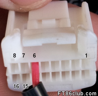

This is a pure guess but could it also be the 16 pins [plug] for us as well? Could the one red cable be from the reversing gear? And since most after market cameras require 12V, do you still have to hook up the camera to the reverse light for power or should most head units supply enough voltage?

Your hunch is correct -- the rear camera input is on the HU's 16-pin socket. Apparently that's a standard for Toyota HUs now.
Yours is like in the BRZ -- the only wire (pin 6) is the parking brake signal. Camera video is on pins 8 (video signal) and 16 (ground / shield).
The reverse gear signal is on the 28-pin harness (pin 2). Your car appears to have that lead, so all you need for the feature to work is for the HU to see a video signal on pins 8 & 16.
Pin-outs of 16- and 28-pin sockets in BRZ here.

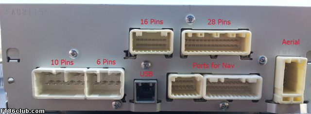

BTW, the 6- and 10-pin harnesses (your pictures 9 and 10) appear to be part of some kind of adapter harness. They're plugged into the "real" factory 6- and 10-pin harnesses behind it, similar to the one shown in this thread: Extra wiring (and a USB surprise). Yours looks like a subwoofer harness. Or maybe a Bluetooth phone adapter harness.
[ADDED: Confirmed: it's from a dealer-fitted upgraded JBL sound system with new speakers and subwoofer]
I've spotted something about your 28-pin harness that leads me to think the one in your pictures is actually a similar type of adapter. Follow the wires farther back and see if they go to another "native" harness with a 28-pin plug. If so, check if that one still has the reverse gear wire.

Sorry, I confused which upgraded HU your car had. Based on both PDFs (nav and non-nav), I have a suspicion that the reverse signal may be one of the things brought in via that long harness G1 that connects near the right door, and the signal won't be on your native 28-pin plug.
I also now see that the adapter harness adds the 16-pin plug -- the drawings say your car didn't have a native one.
I'll see if someone with NAV could also have a look at the 28 pin harness for you as well.
I'd definitely be interested to see pics of their 28-pin connectors. It's still possible that the 28-pin adapter harness is slightly different on the nav version.
